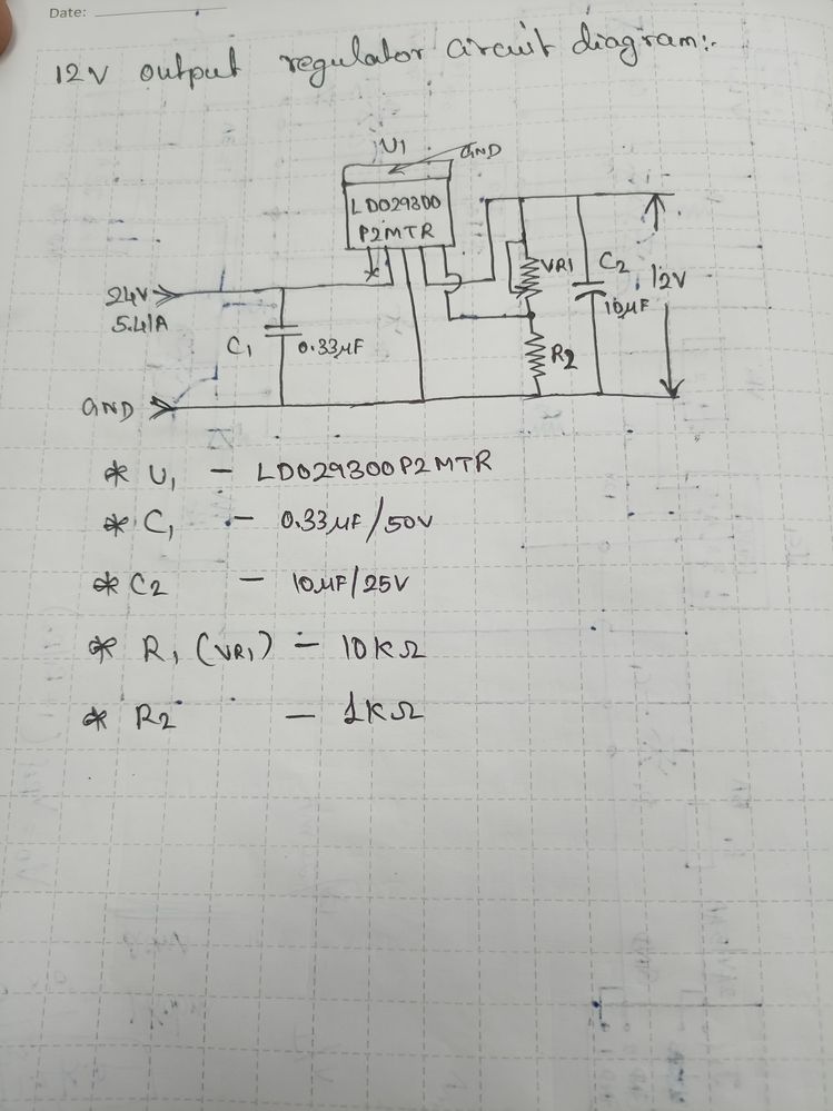

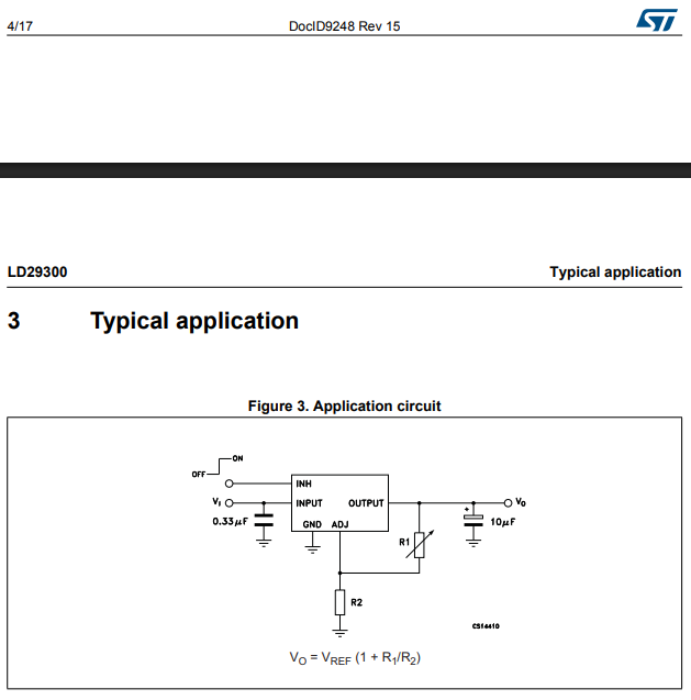

We have implemented the following circuit. This matches the application circuit given in datasheet of LDO29300P2MTR.But it does not yield expected output. We need help!!IMG20250328160749.jpg

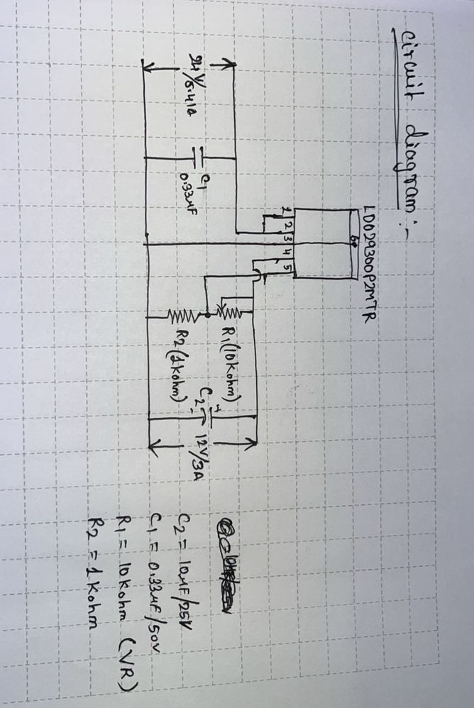

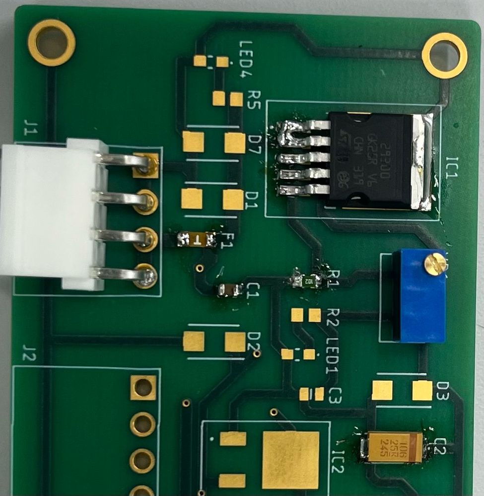

@Andrew Neil

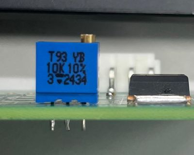

I have attached the images for your reference. Kindly let me know if I have made any mistakes
WhatsApp Image 2025-03-29 at 9.11.29 AM.jpegWhatsApp Image 2025-03-29 at 9.23.29 AM.jpegWhatsApp Image 2025-03-29 at 9.27.10 AM.jpeg

@saran wrote:
 it does not yield expected output. !!
So what output does it yield ?

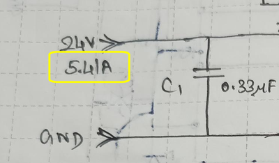

@saran wrote:
What is the significance of the 5.41A there?
The LD29300 is only a 3A regulator ...
https://www.st.com/en/power-management/ld29300.html

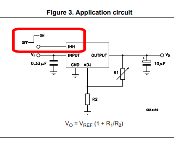

Not quite:
You've left the INH pin open.

The IC takes an input voltage of 24V/5.4A , expected output is 12V BUT IT GIVES 0V . Also where should I connect the INH pin.
The IC takes an input voltage; the current is determined by the load.
@saran wrote:
expected output is 12V BUT IT GIVES 0V . .
The output depends on R1 - so what do you have that set to?
As the datasheet shows - connect it high for 'ON', or low for 'OFF':

R1 value is 10Kohm ; R2 is 1Kohm
@saran Let me tell you what is meant by INH=H: simply connect INH (pin 1) to INPUT (pin 2) to switch the LD29300 on permanently. If you connect pin 1 to GND, you switch it off.

I have shorted pin 1 and pin 2. Still, the output is 0V. If you have any sample circuits for the LDO29300P2MTR, kindly help me solve the issues.
Then check your resistors & wiring.
Perhaps show a good, clear photograph of your setup.
saran
Associate III
@Andrew Neil
