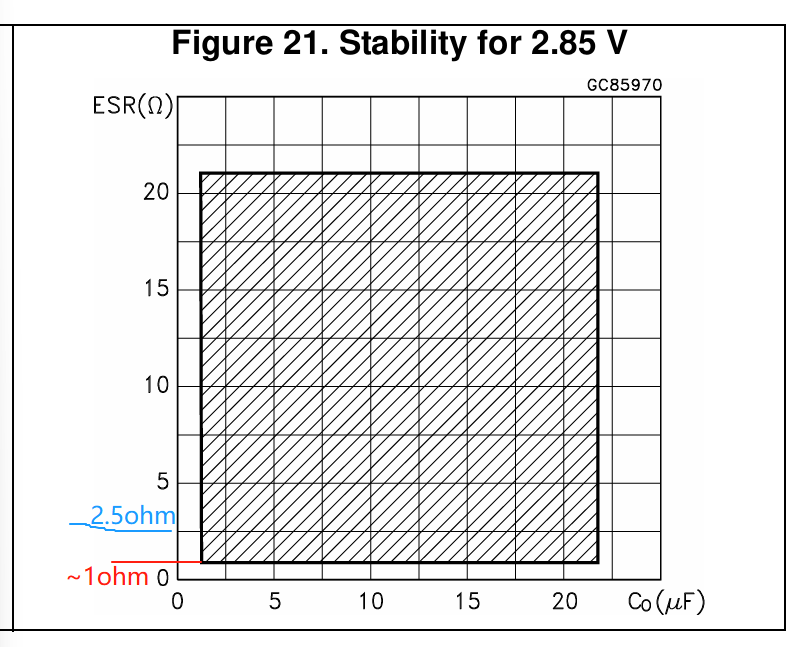

For the LD1086, you will find some tips for stable operation in the data sheet in figures 20 (Stability for adjustable) and 21 (Stability for 2.85 V), from which a minimum ESR of approx. 500 mohms (ADJ) and 250 mohms (2.85 V) can be read. Although the regulator seems to operate on DC, the possible rate of change of the load must still be taken into account for the frequency, so that approximately 1kHz should be assumed depending on the application.

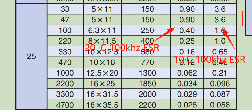

Thank you very much for your reply. Then, when does the situation of "it can tend to oscillate at high frequencies" occur, and what are the consequences of such oscillation? If MLCCs are not used, then when using electrolytic capacitors, we shouldn't need to consider the issue of ESR, right? For example, the 47µF/25V electrolytic capacitor (model: 25YXF47MFFC5X11). In addition, is there any LDO that doesn't require consideration of MLCC ESR? It would be perfect if it is pin - compatible with LD1068.

Thank you very much for your reply, which has given me a new understanding of LDOs and ESR. For LDOs like the LD1086 and LM1117, MLCCs have been used in previous designs, and the system still operates stably (probably because there are no conditions to trigger LDO oscillation, likely due to the absence of sudden load changes). Therefore, I never paid attention to this issue before. That’s why I want to clarify it thoroughly this time.
  1. I plan to use the LD1086 with a 3.3V output. Do I need to refer to the "Stability for 2.85 V" specification to select the electrolytic capacitor?
  2. To keep the LDO stable, does the ESR of the capacitor need to be between 1~20 ohms?

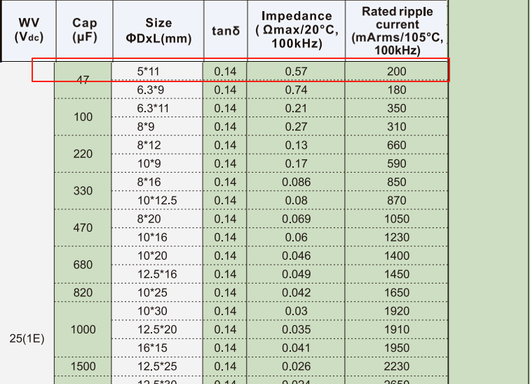

  3. At which frequency should we determine the ESR? 1kHz,100khz It seems that the electrolytic capacitor datasheet does not include a curve showing the relationship between ESR and frequency.?

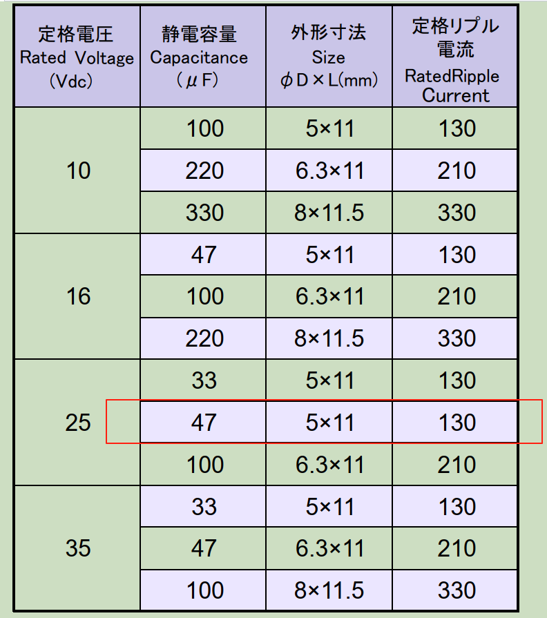

  4. Unfortunately, I couldn’t find the ESR parameter in the datasheets of the following electrolytic capacitors. Only high-frequency, low-impedance electrolytic capacitors provide ESR values corresponding to 100kHz. How should I proceed with the selection?
  5. For the output capacitor, if I choose a 47uF/25V one, do I still need to parallel a 100nF MLCC?
  6. When designing the LDO’s output capacitor, ESR is taken into account. However, in the system, this LDO supplies power to an MCU circuit, and the MCU’s 3.3V rail uses many MLCCs in parallel. In this case, the ESR is far lower than the value required for stability. How should this be explained?(Is it not possible to upload PDF attachments?
111.png1111 ERS1EM470D11OT.png222225YXF47MFFC5X11.png333325YXM47MEFR5X11 .png
  1. The stability zone looks essentially the same for all voltages; with a minimum ESR of 1 ohm, you are on the safe side.
  2. On the one hand, the ESR should be as small as possible for a fast response to load changes, but for stable operation it should not fall below the minimum value mentioned under point 1 above.
  3. Electrolytic capacitors probably have a higher ESR anyway, so you don't need to worry about that. The frequency dependence mentioned above is more relevant for MLCCs.
  4. See 3
