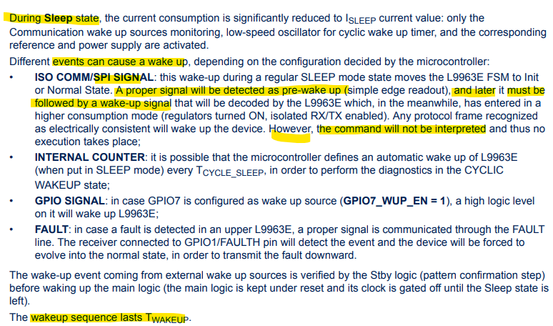

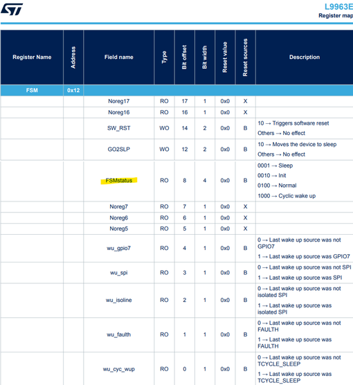

Im using the L9963E for a Battery Management System. I noticed that the device has a register called "FSMstatus". I don't understand if reports the current status or the previous status. For example, if the device is in SLEEP, in order to read the FSMstatus register, I have to wake it up, and the device goes to the NORMAL state. Now the FSMstatus reports the SLEEP or NORMAL state?

2026-04-24 12:44 AM
Hi Lorenzo.
L9963E does not have any register called "FSMstatus"
FSMstatus is actually the name of a field of the FSM register [address 0x12]
This register contains the current state of the device.
Regarding exiting from Sleep state, take a look to page 15 of the datasheet:
So, for example, two SPI transactions are required to exit the sleep state.
Probably, you "may" be able to read a sleep state if enough SPI signals are sent faster than the Twakeup.
A good solution to keep trace of the state of your device is to create a "current_FSM" variable in your code, mirroring the FSM of your IC.
Obviously, you have to maintain it updated, reading periodically the FSM register. But you can also change it manually when a GO2SLP command is sent.

Hi Simone,
thank you for all the information. Eventually I figured it out that the best way to handle the L9963E's FSM is by code and validate it by reading the FSMStatus field, as you suggested.
