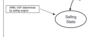

| FENH |
External arming enable for high-side drivers (active high) – used when there is no use sensors, and safing State ARM and VSF won’t be valid as seen in figure. 9)

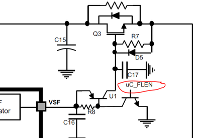

| uC_FLEN |
In the reference schematic, uC_FLEN appears to be used as a GPIO from the MCU to control a FET in the VSF-powered safing path — is this correct? Could this function alternatively be driven by one of the L9678P’s GPO drivers to reduce MCU pin usage? (typically near U1 as shown in Figure 58)

Is my understanding correct that uC_FLEN is a control signal from the MCU used to enable or disable the safing FET path (typically by pulling the gate low)?
What is the recommended driving strategy from the MCU for this pin?
