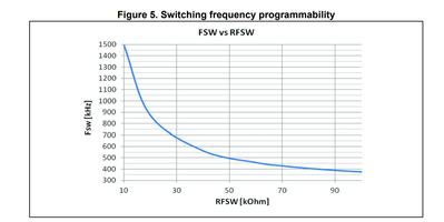

see ds :
setting Rfsw to 10k should give about 1.5M.

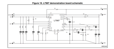

here R8 :

Your circuit (the coil L1 , C5+6) has to match the frequency you want/set .
