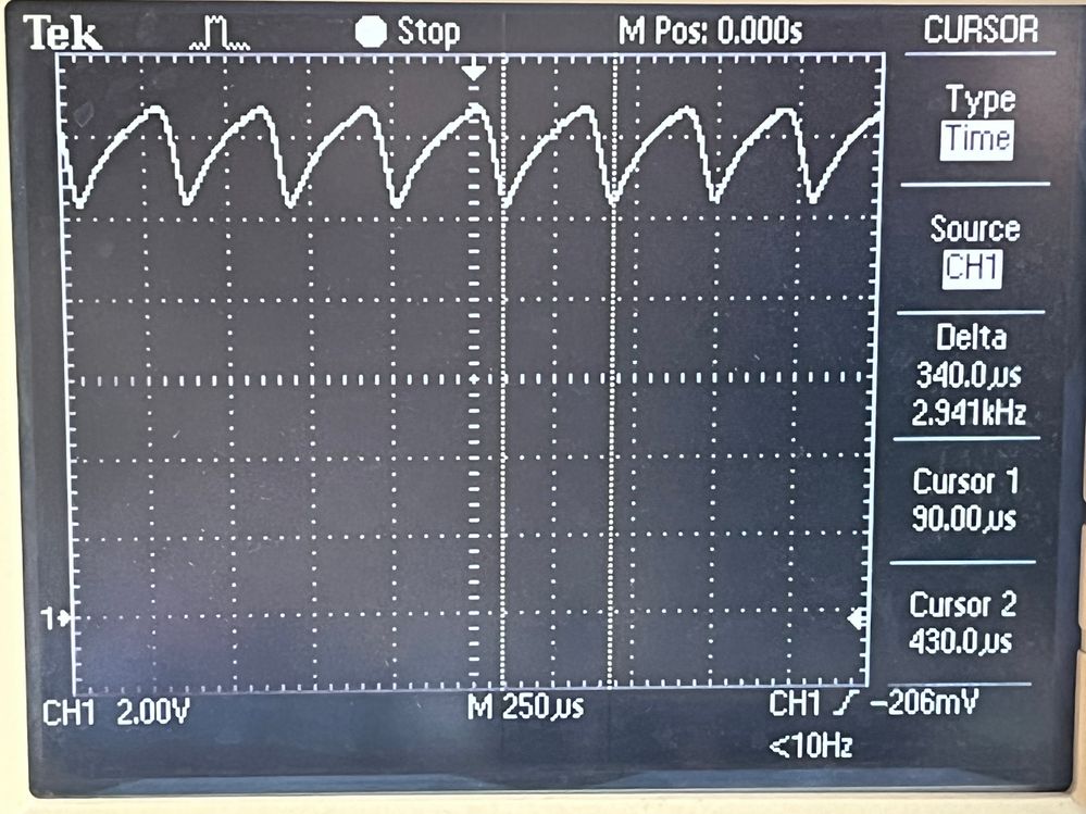

we have two different results of the ripple noise
base on same PCBA design, but different L7987 origin:

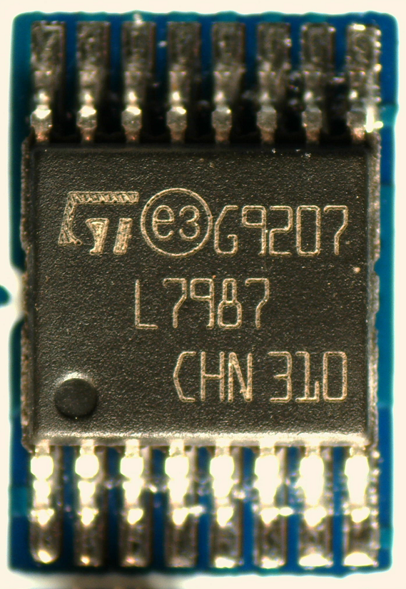

1. Mark of "ST e3 G9207,L7987, CHN 3L0",ripple noise 2.2V 2.9KHz
input 24V, output 12V, load 5ohm 2.4A

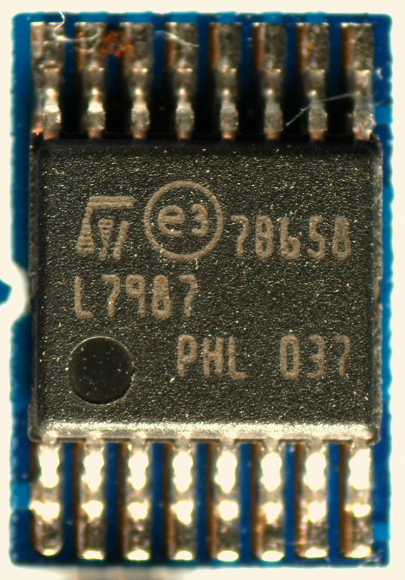

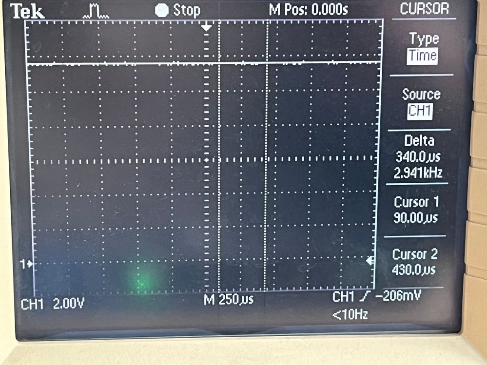

2. Mark of "ST e3 7B658, L7987, PHL 037",ripple noise 0.04V

L7987 CHN 12V 2.5A, 24V in
L7987 PHL 12V 2.5A, 24V in
L7987 CHN
L7987 PHL

The logo on the CHN looks very mysterious, so you should check the origin of this chip carefully. If the supplier cannot provide a Bulk ID, it is probably a fake.
If you have the Bulk ID, please do not post it here due to the risk of misuse, but have it checked by Online Support OLS.

how to find out what the marking "ST e3 G9207,L7987, CHN 3L0" means.
thanks.

It doesn't say 3L0, but 310, which would actually stand for the date code. But as mentioned, I suspect a counterfeit component, which can be recognised by the bulk ID.
