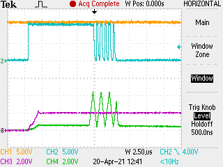

We noticed that there are pulses at the gate drive outputs (pins 15 HVG, & 11 LVG) during the ramp-up of the control voltage (pin 12 VCC).
This is what we saw: when VCC reaches about 11V, a sequence of pulses appear on both LVG and HVG. First LVG went high (VCC) for a long period of about 10 micro-seconds, then it went low, and after a delay of about 300ns, 3 narrow pulses (each less than 250ns wide) appeared alternately on both HVG and LVG, in normal sequence with deadtime of about 300ns, starting with HVG first, and the last pulse on LVG. Then the pulses stop for a very long period (many hundreds of milli-seconds), and then they start again in accordance with the normal function of the controller in response to voltages at the control pins. The behaviour occurred regardless of the rate of rise of VCC, we varied this from very fast (2 milli-seconds rise from 0V to +12V) to quite slow (100ms from 0V to +12V) and each time the response was the same.
We also saw pulses on the timing cap, pin 3 CF. This voltage was held at 0V during VCC ramp, then held at about 0.5V for the first pulse (LVG high for 10us), then it showed the usual triangle waveform for 3 peaks and 3 valleys during the narrow pules on LVG & HVG, then it returned back to 0V.

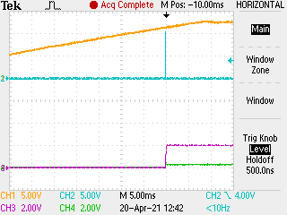

Scope images below:
CH1 +12VA (Vcc)
CH2 XAB
CH3 pin 4 RFmin
CH4 pin 3 CF

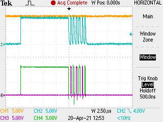

Scope images below:
CH1 same, +12VA (Vcc)
CH2 same XAB
CH3 moved to pin 11 LVG
CH4 moved to pin 15 HVG

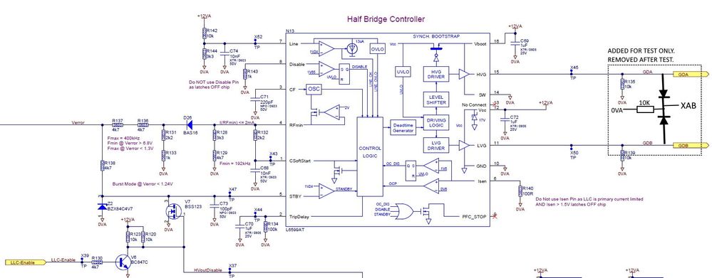

I have already checked the pins you mentioned with a scope, please refer to the 3rd paragraph of my original question. Also, from the schematic it is clear that some pins are not connected to any active device (eg: a logic gate, or transistor) that could cause a voltage, they are held in their de-asserted state (low) by pull-down resistors, specifically:
p6 Isen: 100r to 0V.
p2 TripDelay: 1uF & 100k to 0V.
p8 Disable: 1k to 0V.

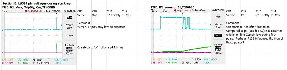

Pin 1 Css: Refer the two images below, the one on the right is a zoom-in of the left image. Please refer to the comments within the image.

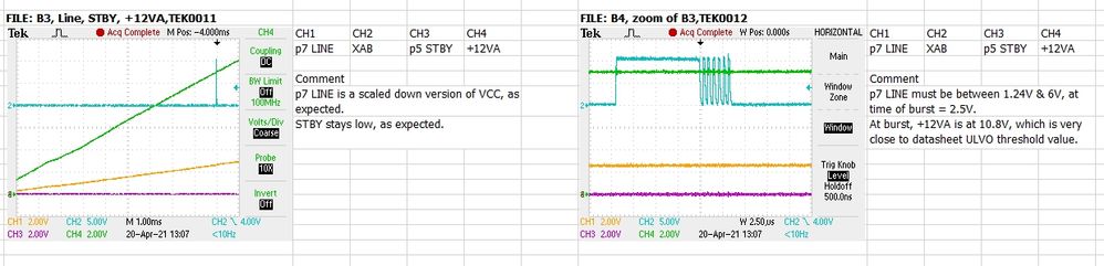

Pin 5 STBY: Refer the two images below, the one on the right is a zoom-in of the left image. Please refer to the comments within the image.
I trust that the above clearly proves that all pins of the L6599 are being kept at the correct state to stop the L6599 from activating its gate drivers during the ramp-up of the control power (+12V).

Anyway, coming to your Q2, the correct way to stop and start the IC properly is controlling the LINE pin. Therefore I suggest to connect the V7 Drain to LINE pin instead of STBY.
