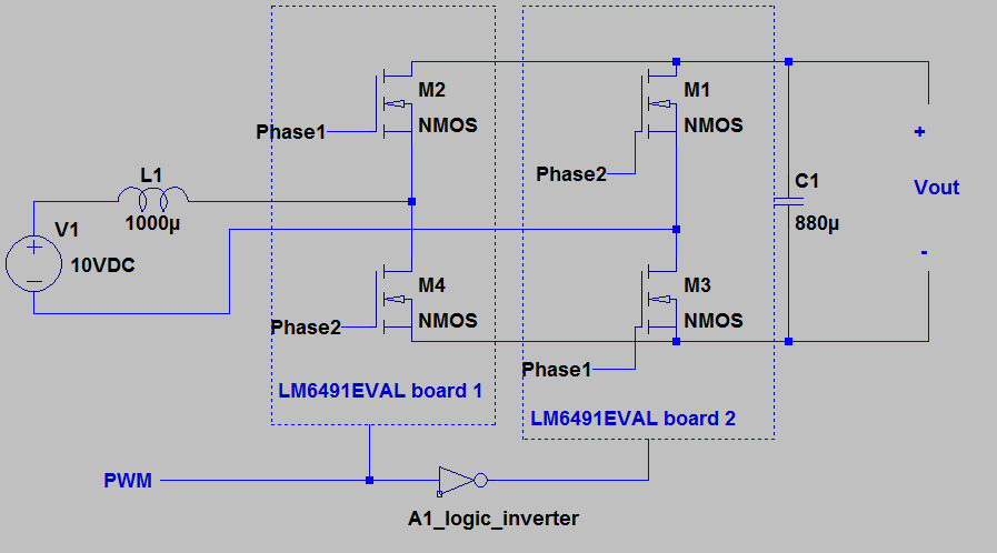

Project: Make one full bridge (non-isolated) rectifier, using two L6491EVAL boards as the gate drivers (the switching transistors mounted to them are FCH190N65F).
Initial testing approach: test the full bridge rectifier circuit as a DC-DC converter (just to verify functionality) by applying 10VDC to the input, vary the PWM duty cycle to each gate driver board, and then measure the output voltage (it should increase as the duty cycle increases). Just for safety/sanity, my 10VDC input source is current limited to 1 amp, and there is no load on the output of the full bridge.

Dear Richard,
we miss some important info: at which frequency and VCC voltage (L6491 supply) are you driving the application?
In the eval board you have to select and mount also the turn-on and turn-off resistors based on the selected MOS and application speed/characteristics. Which values are you using?
Based on your description seems that probably turn-off/on resistors are not sized correctly. If it is the case, the induced turn-on phenomena is occurring or, in an extreme case, dead time is not sufficient.
You can start having a look to a brief description of induced turn-on phenomena in AN2738 page 35 (chapter 9).
Just to speed up the analysis, very often turn-off resistors (R2 and R4) shall have a smaller value (often from 1/10 to 1/3) compared to the turn-on resistors (R3 and R5)
Monitoring with an oscilloscope MOS gates and OUT node you can tune the values to fit your application and check if the induced turn-on phenomena is present. Also monitoring which component(s) is dissipating such energy (which component is too hot) can help you to locate the issue.
