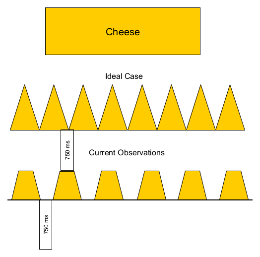

We are working with a Cotton Loom control project that contains about several (14 Nos) of stepper motor, Two of them are Disc Magnetic stepper. We are using the micro controller STM32 for motor driving now we are able to move motor in Clockwise and Anticlockwise, But we encountered a Dead time between Clockwise and Anticlockwise mode.
We tested the operation in
1. Move mode
2. Run Mode
The pattern we are trying to make is shown below
In this design we are using A BLDC motor that is running continues speed on run mode too with the Disc magnetic stepper. The Disc Magnetic stepper is driven through a belt assembly for providing lateral movements.
Awaiting your response on Priority.
