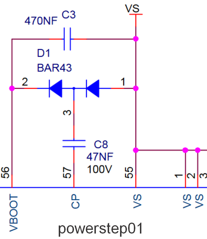

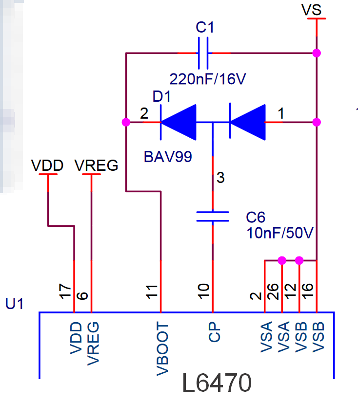

How I can calculate capacitors and diode for charge pump? Can I use schematic (charge pump part) from powerstep01 to L6470?

Hello @dungeonlords789,
the charge pump circuitry values have been chosen according to the power stage integrated in the device.
In the device datasheet you can find the recommended values for both device (the same used in the evaluation board)
The capacitors voltage rating may vary according to the rating of the application.
Due to the high charge pump frequency, fast diodes are required. The BAR43SFILM - small signal Schottky diode - can be used for both ICs.
Let me know if I fully answered your question, if so please "Select as Best" button.
