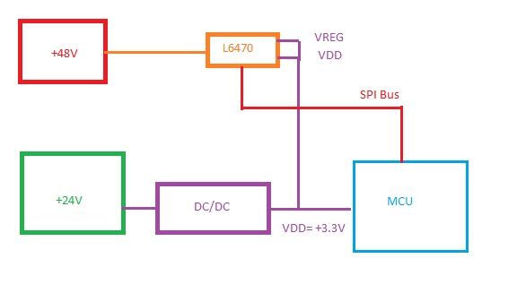

I am designing the system with both L6470PD and L6472PD stepper drivers. Since my system is operating on 3.3V (MCU is STM32F103 ) I have tight the VReg with VDD line as suggested. The problem which I am facing is following. I supply the drivers from 48V while the MCU via DC/DC converter from 24V to 3.3V. If I am turning of the 24V only the logic is still supplied via VREG embedded in Stepper driver ( since 3.3V line is tight with Vreg ). This condition is not good for my application since a) ST not recommended to supply anything from this VREG b) I wanted to be able to turn of the logic completely when I turn on the 24V.
Please advice since it is not clear for me, can I maybe place the Schottky diode between VDD and VReg so there will be no possible supply the system from Vreg?
Or maybe I can leave open the Vreg and not tight this to VDD
Any suggestion is more than great.

Is it possible you can draw and post a block diagram of the power sources and how you have them connected or wish to have connected ? Not 100% following the setup. You can also submit this as a support request via support home via web request on st.com

Here is the block diagram..
Basically I am planning to use 48V to supply the power stage of the H-bridge in L6470 to drive the motors with defined torque. +24V is my main power supply for the rest of electronic system. I am rectify from 24 to 3.3V to supply MCU, Following to spec from L6470 I tight the VREG and VDD to 3.3V line. Now there is a scenario when I unplug the +24V input the MCU is still alive since is sourced from internal VREG from L6470 which is not good in my case ( i need switch off logic completely ). Can I place the Schottky diode in the way that I will be not able to source from VREG the logic , and if yes what I am risking there?

Thanks a lot for replay. Unfortunately is working in this way if I turn off 24V I will have 3.0V on the VDD rail ( not 0V ) from the internal regulator embedded in the L6470PD ( Internal VREG rectify from 48V to 3.0V ) , so my MCU will still respond. So my idea around Schottky diode was to not allow to feed anything from VREG.
