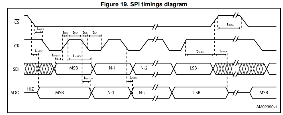

I know this is an old question, but I have seen this issue trouble a few customers and this question pops up when you search for it.
If the L6470 seems to always be Step Clock Mode or you are seeing other oddities in communication, it is most likely due to an incorrect setting for the SPI clock polarity and/or phase. If this is not set properly it is possible to have most of your communications appear to 'work', but you may still have some issues especially with things like the SCK_MOD bit in the status register which is the MSB that is not being clocked in properly.
This may manifest in other registers or on other devices as well like the L6472, L6474, L6480, L6482 or the powerSTEP01.
