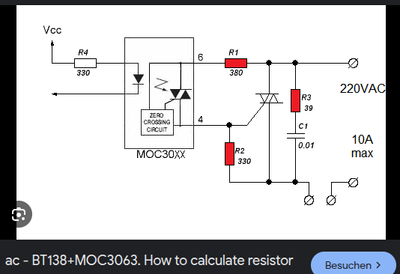

100Hz pwm is so low - why not use a thyristor or triac ? with a triac you need even no diode bridge and no gate driver+supply, just a optocoupler-trigger, like MOC3052 (random control) and BTA16-600 :
