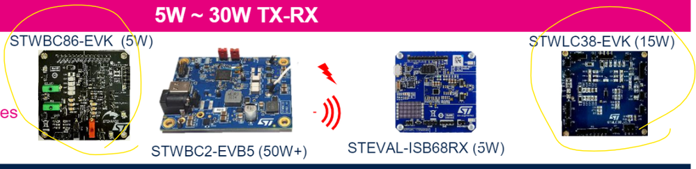

Im really in rush, Please help me. How can I get STWBC86-EVK and STWLC38-EVK ?
JAKE2
Associate III
Hi, where can I get these two EVK?
Since I searched these EVK model for 3 hours, and I can't find any.
I searched all the sites including..
(Mouser, Element14(Farnell) Digikey Avnet Arrow Newark OneChipStore, etc.)
Can you help?
