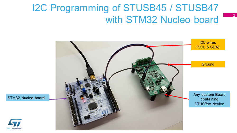

A simpler alternative to program the STUSB4500 NVM memory is to use the STUSB4500 GUI with a STM32 Nucleo board.
The Nucleo board is only $10. So it is a low cost I2C programming tool, and ready to use by flashing the right firmware.
https://www.st.com/en/evaluation-tools/nucleo-f072rb.html
You just need to connect the I2C pins (SCL, SDA, GND) from the Nucleo board to the I2C pins of the board where is located STUSB4500.
Then you can use the GUI to configure the device.
STSW-STUSB002 : Graphical User Interface for STUSB45
