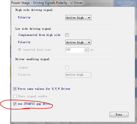

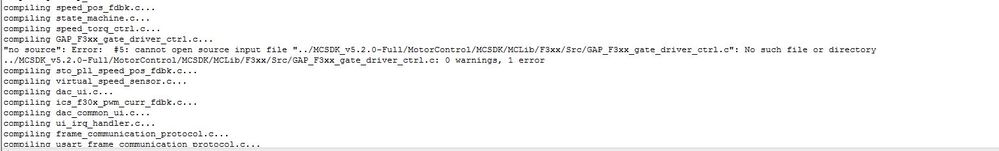

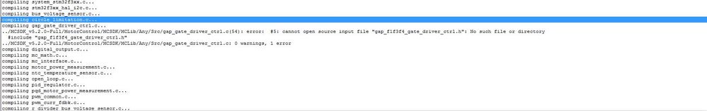

I tryed to use the MotorControl Workbech to generate a project , and I checked the "use STGAP1S gap drive" like the photo, I builded the project , but failed ,and it prompted that "../MCSDK_v5.2.0-Full/MotorControl/MCSDK/MCLib/Any/Src/gap_gate_driver_ctrl.c(54): error: #5: cannot open source input file "gap_f1f3f4_gate_driver_ctrl.h": No such file or directory" ""no source": Error: #5: cannot open source input file "../MCSDK_v5.2.0-Full/MotorControl/MCSDK/MCLib/F3xx/Src/GAP_F3xx_gate_driver_ctrl.c": No such file or directory"
