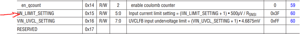

Hello ,
Battery charge voltage is pin selectable and I 2C adjustable. Input current limit and charge current can be accurately programmed with sense resistors and can be individually adjusted via the I2C serial port
So you can try to manage your application via I2C commands :
/* Write an amount of data in blocking mode to a specific memory address*/
HAL_I2C_Mem_Write(I2C_HandleTypeDef *hi2c, uint16_t DevAddress, uint16_t MemAddress, uint16_t MemAddSize, uint8_t *pData, uint16_t Size, uint32_t Timeout);
/*Read an amount of data in blocking mode from a specific memory address*/
HAL_I2C_Mem_Read(I2C_HandleTypeDef *hi2c, uint16_t DevAddress, uint16_t MemAddress,uint16_t MemAddSize, uint8_t *pData, uint16_t Size, uint32_t Timeout);Foued
2023-02-24 2:21 AM
How to implement this, can you please tell me.
2023-02-24 2:49 AM
First of all, please
Open STM32CubeMx and start the configuration.
Generate code (choose your IDE)
HAL_I2C_Mem_Read(&hi2c1, DevAddress, 0x15,1, (uint8_t*)(®ister_value), 1, 1000);Hope my answer helped you!
Foued
