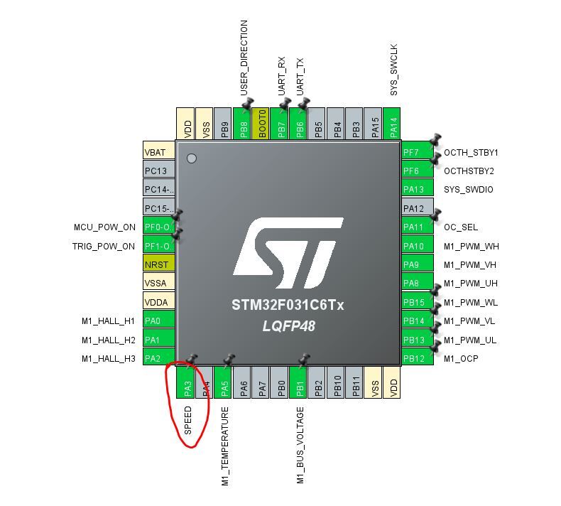

the potentiometer feature is included in the example 6S_Steval_ptool_1v1_HS_VM.
In fact, the firmware continuously acquire the PA3 pin (named “SPEED�? in the IOC file), every “POT_UPDATE�? milliseconds (defined in the main.c file, default value 200 ms).

Hello @Community member​ ,
Once you click the GENERATE button, the proper configuration is lost and you can't recover it by clicking UPDATE the next time.
The right process to have a working code is strictly following the instructions in the readme.txt file that should pop up when you open the example in the MCSDK Workbench.
I suggest you to delete the created folder and start again from scratch, reopening the example, saving it without renaming it and then click the UPDATE button.
You should then obtain an IOC file like in the picture.

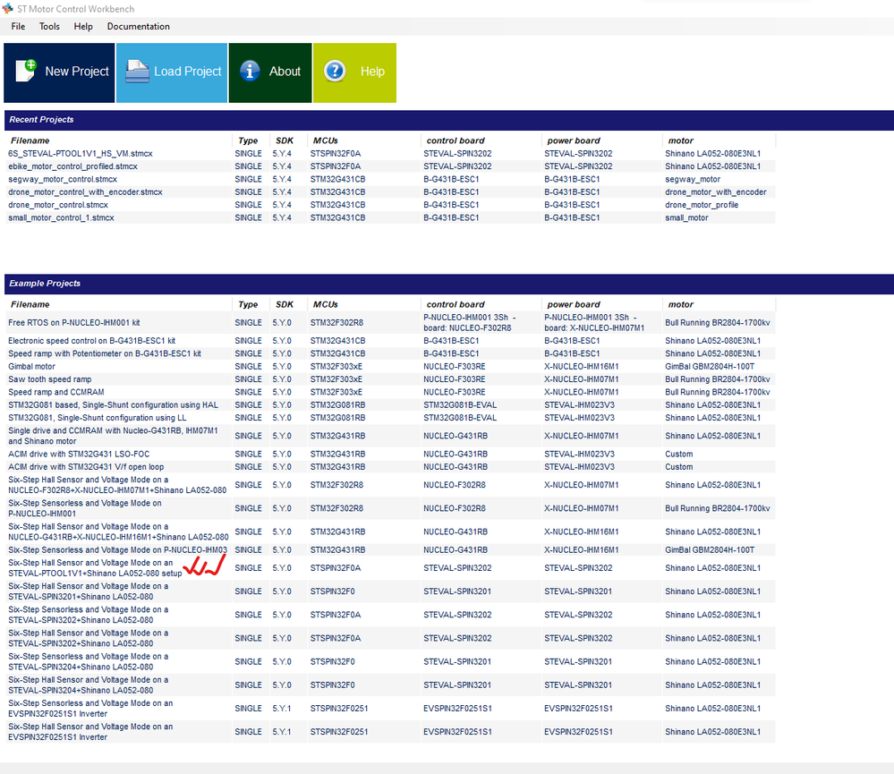

There are two ways I'm able to load example code into the MC WB, out of which only one generates the SPEED pin.
1) One that works - is by selecting it from the menu like below:0693W00000Y7056QAB.pngThis one generates Speed Pin.
2) The other method is loading the .stmx file from the project folder in the MC-SDK installed directory (which doesn't generate SPEED Pin). So ignoring discussing about this.
Now using method 1, the example is designed for another motor. I am changing the motor parameters in the MC WB 'motor part' denoted by "M" before saving and generating code (pressing on UPDATE and not GENERATE) i.e, assigning Pole pairs, voltage, disabling the encoder, activating the Hall sensor option, etc.

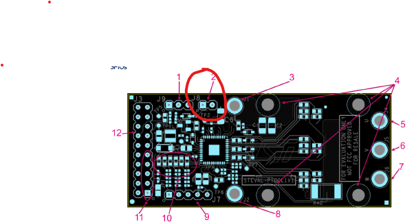

I have connected a jumper to J8 in the place shows below:
0693W00000Y7ix7QAB.pngThis Jumper is always connected even when I program the board using ST-LINK.
I have no error coming up since the motor does not even engage.
Can you please tell me what you mean by OUTPUT? Do you mean the PWM signal from the microcontroller?
