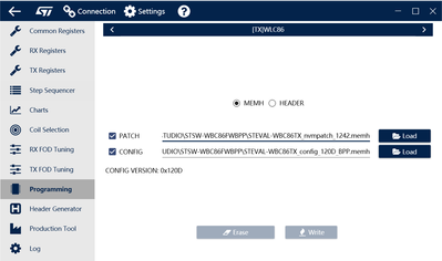

Hi there,
For update of FW (patch and config) in STWBC86, the easist way is to use
our dedicated GUI available on https://www.st.com/en/embedded-software/stsw-wpstudio.html and the FW itself is available on https://www.st.com/en/evaluation-tools/steval-wbc86tx.html#tools-software. The step-by-step procedure on how to update the FW is described in User Manual UM3161.
Please let us know if you have further questions.

Hi there,

Hi Janice, I'm also trying to program a STWBC86 but the links for the FW and the User Manual are broken links. Can you let me know where to find these files?
2024-08-19 12:18 AM - edited 2024-08-19 2:06 AM
Sorry this file is update now
ABOUT FW please go to GitHub - STwirelesscharger/STSW-WPSTUDIO: ST wireless charge chip tool
