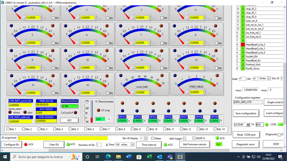

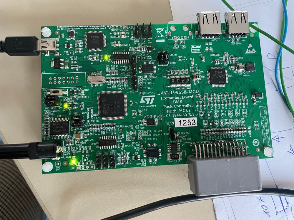

The main issue is that when i enter 1 in the ID assignment, as i'm using the L9963, the ACK LED wont turn green but red instead. The D13 LED on the board behaves consistently with what is written in the application note i.e. is tuned on when the Configure IDs Button is pressed. Do you know how to solve this in order to test the L9963 functionality? Thanks in advance.

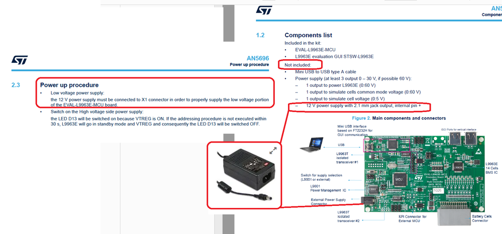

There is an issue when using only 5V USB to power the board apparently.
Use 12V PSU to power the board.

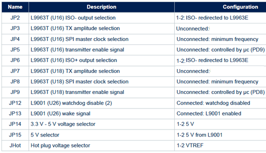

Jumper settings for 12V PSU

You need to power the board with a 12V power brick . It is not designed to run off the 5V USB power.
Its written in the application note .

I'm powering the board with 12V and have the jumper settings like you told us but it’s still not working.
2023-01-10 5:04 AM

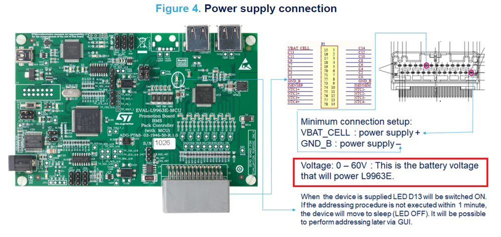

the 12V brick powers the MCU , but the L9963E is separately powered via the P2 multi pin connector. Please refer to attached application note.
If you don't have battery , minimum connection is 12V power supply to VBAT_CELL pin and GND_B.

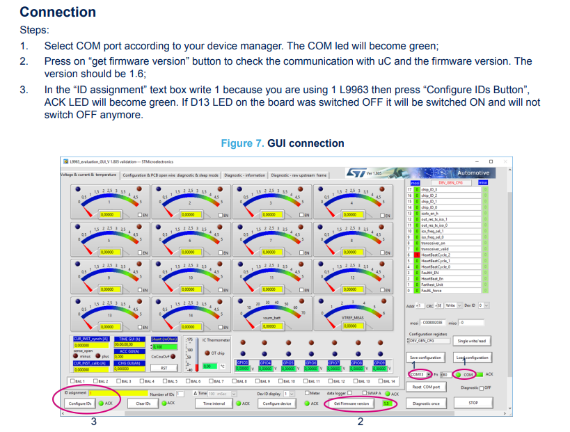

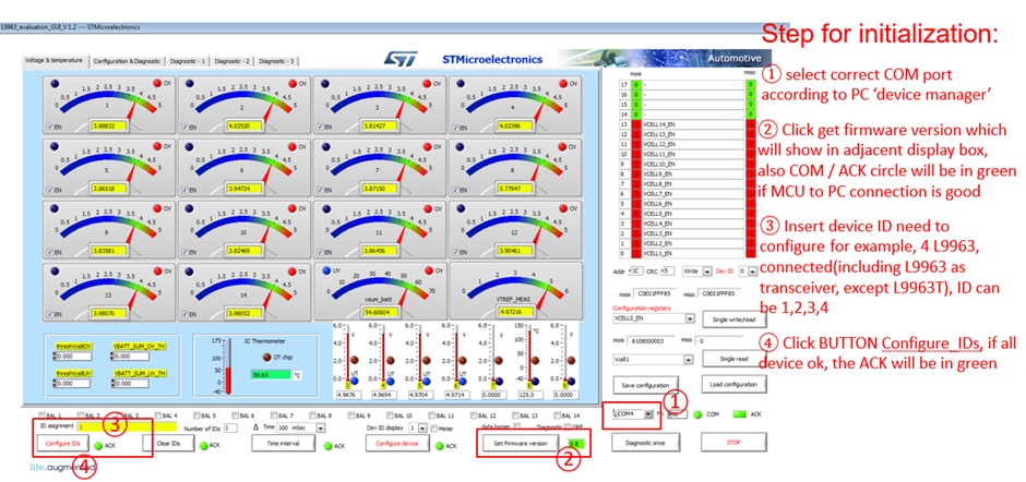

Procedure -
