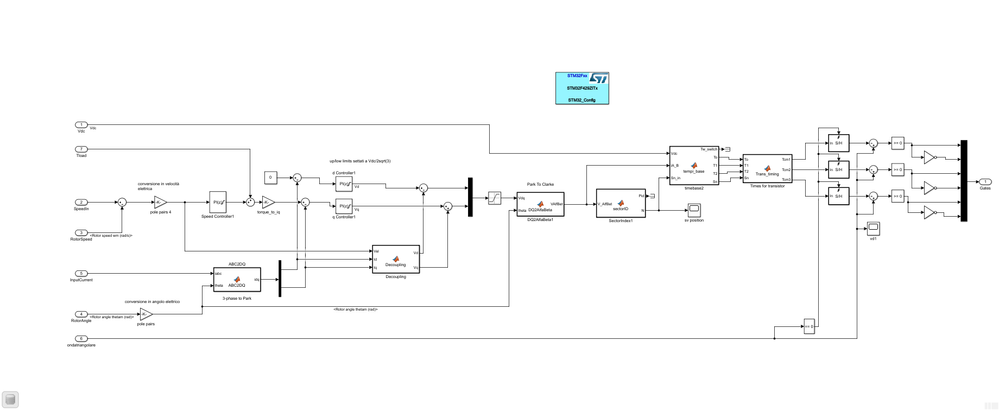

Hello, i'm here to ask you becouse i not understand how improve (if possible) the time spees in PiL mode. i've build my FOC+Space Vector compute model on simulink (there are sin, cos functions for Park Transforms ) with fixed step size of 1us, and 1.8 sec of simulation finish in about 1m30sec. If i run the same reference model in PiL, the model finish the simulation in about 8 hours... Now i know that PiL is a asycronous mode simulation, but for me is not this centre on the times issues. i've set the comunication as well as the handon pdf provided by stm32mat/target but with heap size 400... the stm32f429 is set at 180Mhz, usart to 15200bauds . i've not the execution profile report becouse simulink is crashed when i've tried to open it...

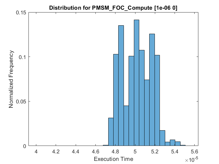

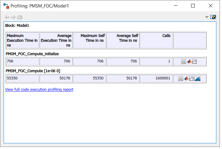

Little Up! Finally, after 2 freezed simulation, at the 3rd, i have some information about the execution time(only of the PiL block), but.... i don't know how they should be interpreted...
ExecutionTimeTaskSection with properties:
Name: 'PMSM_FOC_Compute [1e-06 0]'
Number: 2
ExecutionTimeInTicks: [1×1600001 uint64]
SelfTimeInTicks: [1×1600001 uint64]
TurnaroundTimeInTicks: [1×1600001 uint64]
TotalExecutionTimeInTicks: 14451362954
TotalSelfTimeInTicks: 14451362954
TotalTurnaroundTimeInTicks: 14451362954
MaximumExecutionTimeInTicks: 9963
MaximumExecutionTimeCallNum: 329556
MaximumSelfTimeInTicks: 9963
MaximumSelfTimeCallNum: 329556
MaximumTurnaroundTimeInTicks: 9963
MaximumTurnaroundTimeCallNum: 329556
NumCalls: 1600001
ExecutionTimeInSeconds: [1×1600001 double]
Time: [1600001×1 double]
any one can explain me if this times are good for a motion control? :\ i not understand
