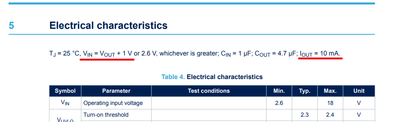

@ves011 The max 600mV for the LDL1117 is specified for an input voltage that is at least 1V above the output voltage. With your small voltage difference, I would recommend switching to an ultra-low dropout LDO, e.g. the LD39100PU33R.

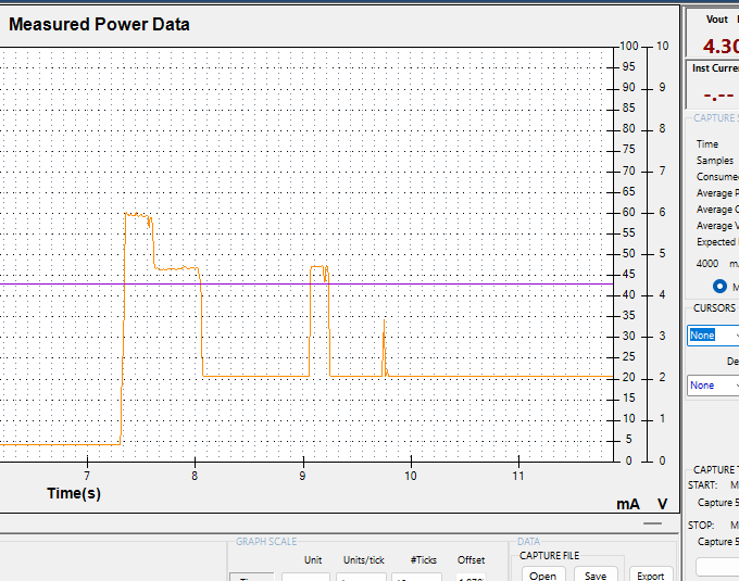

Here is the boot current captured with power monitorScreenshot 2024-11-27 170250.png
its 60mA. Later on when WiFi is enabled and communication starts it has spikes of ~500mA

What @Peter BENSCH said confirmed your findings.
4.3 - 3.236 = 1,064V
4.3 - 3.236 = 1,062V
4.1 - 3.040 = 1,06V
4.0 - 2.942 = 1,058V
