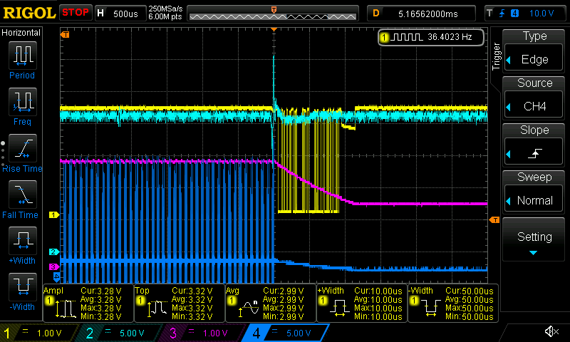

The reason for this question is that, we are plan to make a BLDC using stspin32f0. When we test our first demo board, we find that the motor will stop spin when VM are greater than 15v. After our several days testing , we konw it is something realted to the stspin32f0's VDDA: when the VM is about 15v and a ripple with 5v vpp will cause VDDA drops form 3v3 to 0v.
the following pics shows what is happed befor motor stop:
CH2 is the VM , CH3 is VDDA, CH4 is SW.
pic1 is a whole overview.

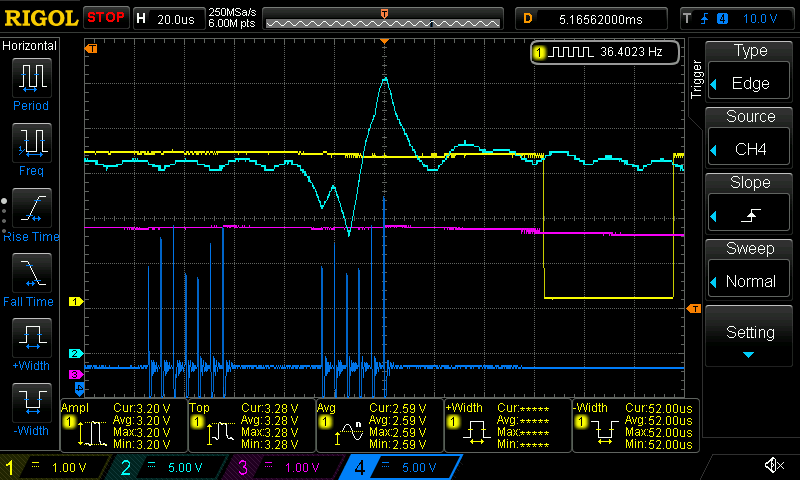

pic2 is a zoom in which could tell the detailed things.

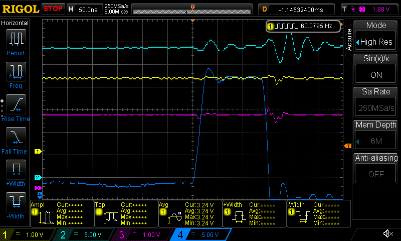

pic3 is the last SW pulse before the internal buck stop work.
So can we say that, the minium SW will be about 100~150ns?
And is there some mechanism that prevent the SW pulse short than 100~150ns?

There is a dedicated AN about the buck converter of the STSPIN32F0 (AN5128) explaining the basic principles.
The SW behavior you posted fits with the normal operation of the converter, but I cannot say the same for the shutdown, of course.
I think something is triggering the overcurrent protection of the buck converter.
