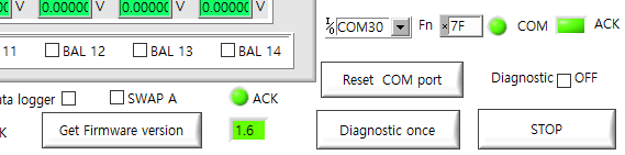

hello. I operated the EV KIT with the STSW-L9963E GUI, and checked until the MCU was connected. After that press the "Configure IDs" button and the ACK LED will change from green to red. And then there is no communication. I ran the GUI as written in the application note.

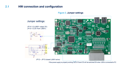

2023-08-02 11:51 PM
Cross check your jumper settings again with the manual
2023-08-02 11:54 PM
make these jumper settings, it will work
