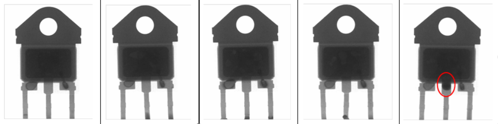

These 5 pcs were mounted on board and test for functional and found 1 component failed then we do x-ray to see what different for good and fail component is.
This is x-ray picture of the good and fail component. There is some excess die/lead frame at the middle leg.
What is the cause of the failure? Is this situation normal?
