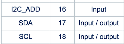

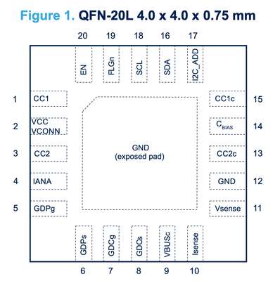

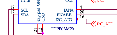

RE: https://www.st.com/resource/en/datasheet/tcpp03-m20.pdf Footer Notes: DS13618 - Rev 3 In Figure 1, the pin 16 and pin 17 are swapped:
