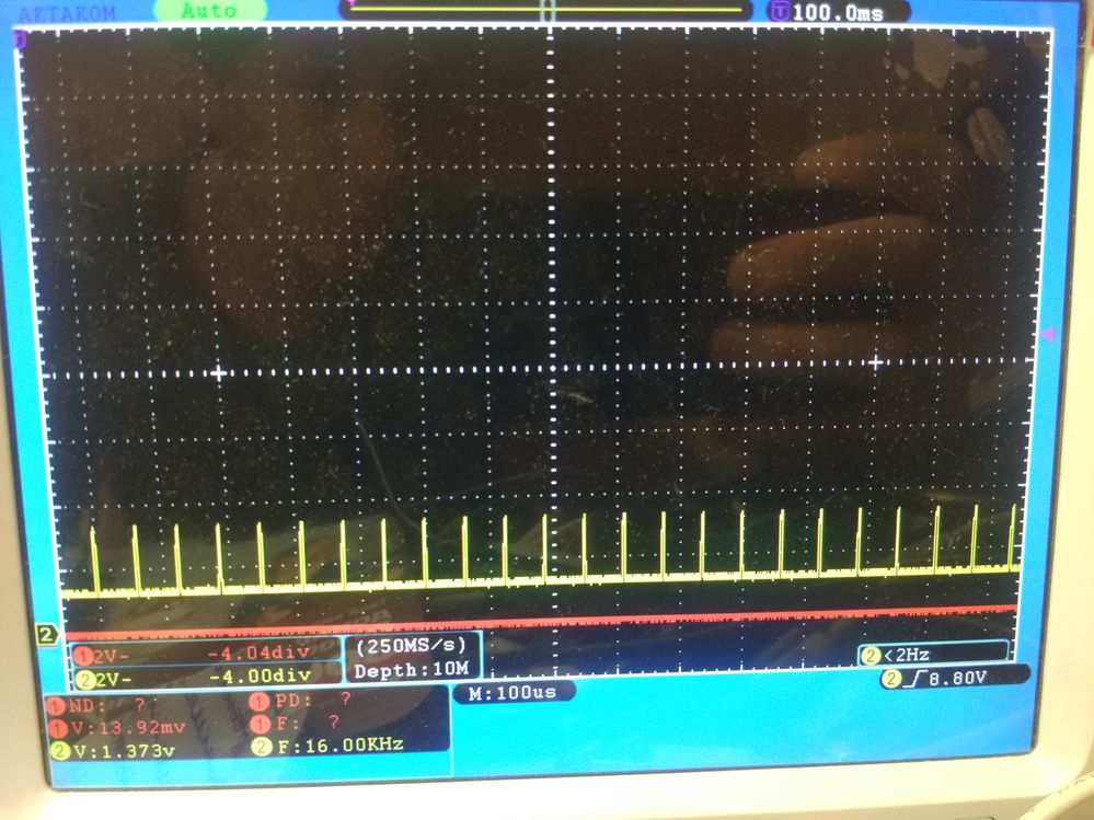

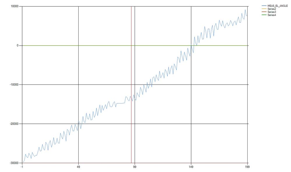

Hello!
I have same problems with encoder. counter in TIM4 counts encoder steps with error in some cases.
I made experiments without V+ connected, power was only through USB port.
value constanly (on pic 1)
I wondered this "magic" and used oscilloscope..
In RUN state:
Red line is V=0, Yellow line is signal on "Encoder A" pad on the board. with no encoder connected
In STOP state signal on this pad is correct.
My both kits has the same problem.
What should I do to fix this problem?
