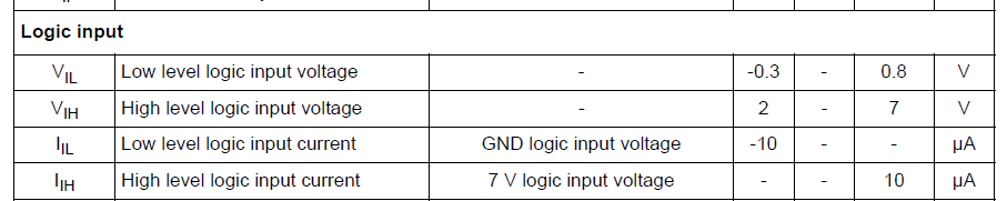

Concerning the value of the RC network on ENx pin, the recommended value is 100kohms.
But, the datasheet gives a low level logic input current of 10µA.
If we apply this on the Enx pin, this means that the voltage across the REN resistor could be 100kohms x 10µA = 1V
In my case, as I use 4 bridges in parallel, the 4 Enx pins are tied together and my input current could be 4x10µA = 40µA.
I could have 4V accross the REN resistor. This value is much higher than the Low level input Voltage(0.8V)! That's why I used a smaller resistor.
But perhaps I'm wrong and the ENx pin is not considered as a logic input ? So I could keep the 100kohms resistor?

Concerning the low logic level current I checked the parameters distributions for both EN pins and the measured current is about zero (some tens of nA).
I agree that the limit in the datasheet is misleading, anyway I confirm my suggestion to use 100 kohm and 5.6 nF for RC network on the enable pins.
