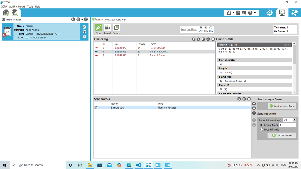

Hey, I am working on Xbee with stm32, and I am getting a big problem while connection.
I am using two Xbee's one is configured as a standard router which is connected to UART1 of the
stm32 controller and the other is configured as a coordinator which is connected to the com port of another system through RS485 cable to XCTU. I have to use them in API mode. I have configured both of them in API Mode, now I am able to send API data frame from router to coordinator , but I cant receive API frame from coordinator to router ?
When I send a simple API frame from the coordinator to the router, the router Xbee sends an acknowledgment frame back to the coordinator, but my controller does not receive any frame, I have written the code to receive the complete frame at once using the polling method as well as interrupt method as well as to fetch the data in single-byte also. But it's not working. Data is received up to Xbee but the controller does not receive anything. It stops the further processing.
See first router sends some random message to coordinator, then from coordinator I have sent Sample data frame to router , it acknowledges back but after that router should send received data back to coordinator , but its not processing?

Got the solution. It's not the problem of STM. It was related to the XBEE module built-in protocol. It's like, when you power on XBee and if it is in API mode, it sends the MODEM STATUS frame to uart of 6 bytes. And that's why the problem persists. So inside the stm program, you have to first receive these 6 Bytes ofthe frame and then start UART functioning and UART interrupts. It will work perfectly.
