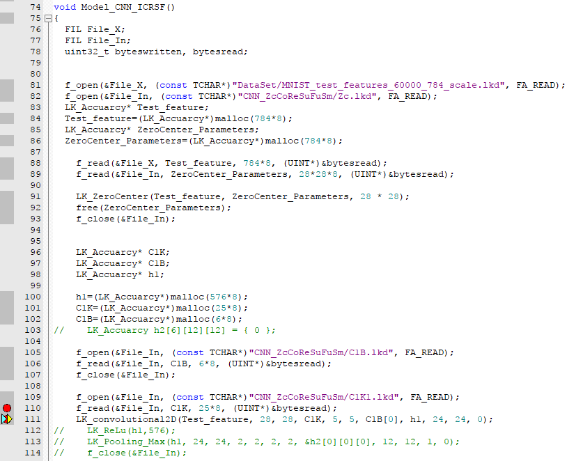

in my function, several heap pointers are defined like this
when I comment the 111 line. the whole code works well. But when I add this line, the pointer Test_feature, ZeroCenter_Parameters, C1K,C1B will all, or sometimes partly, point to 0x000000.
eventually in 2 debug with the same code, it may different.
so the Question is:
In general, What will let the Heap pointer point to 0x00000? before free.
for my observation, the heap size is enough on my project (HEAP SIZE=0x8000, the same as stack size). I'm using STM32F746NG-Discovery Board so the RAM Space(at least 240KB for algorithm) is also enough. So it may be the problem of the IDE or Compiler?
My environment:
KeilV523, STM32F746NG-Disco, Win10 Edu.

before the free operation, the pointer will be pointed to 0x00000. who did that?

The more important thing for me is, in another function. It seems like this
double* A;
A=(double*)malloc(784*8); double* B; B=(double*)malloc(784*8);/* some operation, all function */
free(B);
double* h1;
h1=(double*)malloc(576*8); memset(h1,0,578*8); double* C1K; double* C1B; C1K=(double*)malloc(25*8); C1B=(double*)malloc(6*8);/ *some operation, all function */
the heap this part needed is around 13 Kbytes. And free heap space is 0x8000=32 Kbytes.
The problem is:
When malloc the C1K and C1B, it return NULL, the others work well.
But when I comment the 'memset(h1,0,578*8);', all malloc works well.
the A B h1 get the same address with and without the memset line.
what do you think will let the C1K C1B get zero in general? Only due to the Heap Size limitation?
