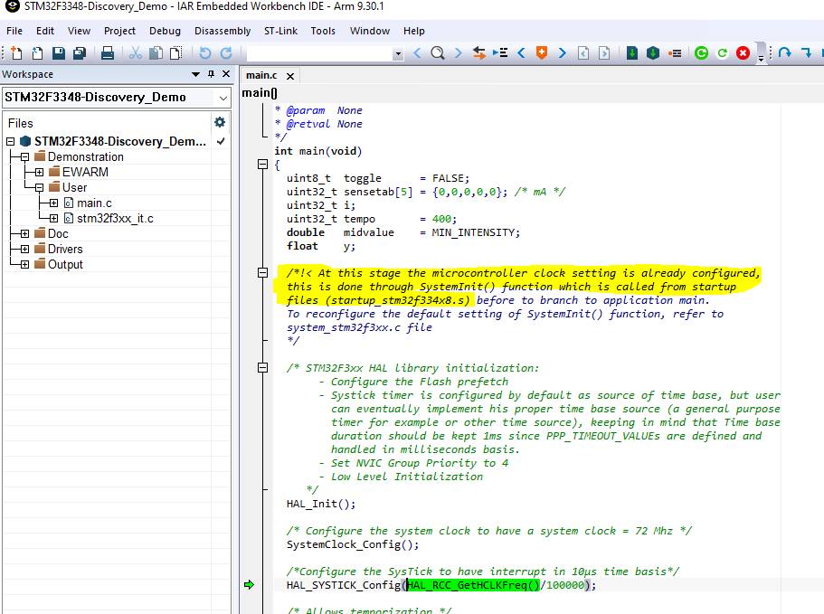

Yes, the example code seems to work with IAR, thank you very much for the suggestion! Now, there is something very interesting going on as it was mentioned in a comment some crucial processor clock settings are in an .s file, and that these are set up before even reaching the main() entry point (see highlighted text). Is for the STM32CubeIDE the .ioc file equivalent to the .s file here, and could my failure to debug any code have originated in an incorrect .ioc setup? There were only some warnings, but none of the clock settings were red. I thought that the .ioc file is only creating a text substitution, updating the init function with the correct commands.I appreciate any explanation / link, as that seems to be the root cause of all my troubles with the CubeIDE.

The startup.s file typically contains the vector table, and enough assembler code to get the C Runtime working. In the CMSIS implementation you typically call SystemInit() to get the MCU and external memories functioning to the point where C statics and C++ constructors can be initialized, before calling main()
On IAR some of this is done via __iar_program_start
THUMB
PUBWEAK Reset_Handler
SECTION .text:CODE:NOROOT:REORDER(2)
Reset_Handler
LDR R0, =SystemInit
BLX R0
LDR R0, =__iar_program_start
BX R0SystemInit() typically lives in system_stm32f3xx.c or similar file. Often get the FPU started, clocks/PLLs, and points the Vector Table into SCB->VTOR register.
