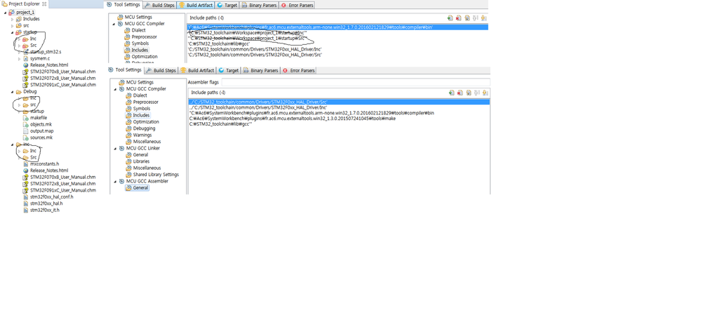

2016-12-06 6:41 PM
Dear Sir Aaron,
I think I did some mistake while creating my project in SW4STM32,
I just opened previous cubemx project, tried to add some files from coo-cox.
Now take a look, same source and include file are in different folder and your suggested setting.
That is wrong, isnt it?
Still the problem says,
arm-none-eabi-gcc -mthumb -mfloat-abi=soft -E ''-IC:\\Ac6\\SystemWorkbench\\plugins\\fr.ac6.mcu.externaltools.arm-none.win32_1.7.0.201602121829\\tools\\compiler\\bin'' ''-I'C:\\STM32_toolchain\\Workspace\\project_1\\startup\\Inc''' ''-I'C:\\STM32_toolchain\\Workspace\\project_1\\startup\\Src''' ''-IC:\\STM32_toolchain\\lib\\gcc'' -IC:/STM32_toolchain/common/Drivers/STM32F0xx_HAL_Driver/Inc -IC:/STM32_toolchain/common/Drivers/STM32F0xx_HAL_Driver/Src -O3 -g3 -Wall -fmessage-length=0 -ffunction-sections -c -o ''startup\\Src\\stm32f0xx_ll_utils.o'' ''..\\startup\\Src\\stm32f0xx_ll_utils.c''
..\startup\Src\stm32f0xx_ll_utils.c:39:32: fatal error: stm32f0xx_ll_utils.h: No such file or directorycompilation terminated.I think,
stm32f0xx_ll_utils.c is still in the path.
Regards
Hasan

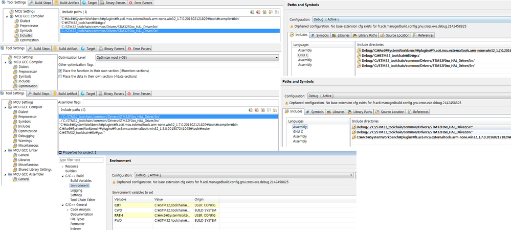

2016-12-06 9:06 PM
Dear Sir,
I also do believe it comes from C file, we saw it before and talked a lot more.
Do you think what mistake I am doing is, indicating same (
stm32f0xx_ll_utils.h)
file path in different folder at project tree?Take a look the second image.
To get relief from this file, dont you suggest me to remove such low level '
_ll_' type files?
Regards
Hasan

2016-12-06 10:45 PM
Dear Sir Clive1,
I'd much rather you start studying some documentation for one chain, and create simple projects until you understand how to use the tools instead of spending weeks going in circles. Your boss needs to provide you with support, or staffing, to achieve the goals if this is a critical project.
I will for sure study the d
ocumentation for one chain.
At this moment, I find a clue (not sure its a reason)
As you said,
''../Inc'' must be follow, I saw my Korean WIN OS, might be showing 'W' symbol instead of
I have correctedthis sign.
If you cant see the image in this post, kindly find it in attachment.
Now the console says,
4:32:45 **** Incremental Build of configuration Debug for project project_1 ****
Info: Internal Builder is used for build arm-none-eabi-gcc -mthumb -mfloat-abi=soft -E -IC:/Ac6/SystemWorkbench/plugins/fr.ac6.mcu.externaltools.arm-none.win32_1.7.0.201602121829/tools/compiler/bin -IC:/STM32_toolchain/Workspace/project_1/startup/Inc ''-IC:/STM32_toolchain/Workspace/project_1/startup/Src -I'C:/STM32_toolchain/lib/gcc' -I'C:/STM32_toolchain/common/Drivers/STM32F0xx_HAL_Driver/Inc' -I'C:/STM32_toolchain/common/Drivers/STM32F0xx_HAL_Driver/Src' -O3 -g3 -Wall -fmessage-length=0 -ffunction-sections -c -o startup\\Src\\stm32f0xx_hal_rtc.o ..\\startup\\Src\\stm32f0xx_hal_rtc.c'' arm-none-eabi-gcc: fatal error: no input files compilation terminated.14:32:46 Build Finished (took 76ms)
Have you see no
LL files, exists here.
What to do with ''
fatal error: no input files''
