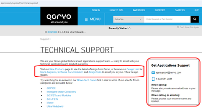

2024-10-23 1:06 AM
I already tried to get answers on Qorvo forum but I am getting no response at all.
A Sniff code has been provided but its for a BLE sniffer and I will need to start working on nrf sdk to utilize that.
I checked using a dummy antenna and oscilloscope . I know the wave exists and is being transmitted as I checked on DSO but again I need it to be recieved on DWM1000 module
2024-10-23 1:16 AM
So have you contacted Qorvo support?
2024-10-23 1:49 AM
yes , did that too . No response till now
