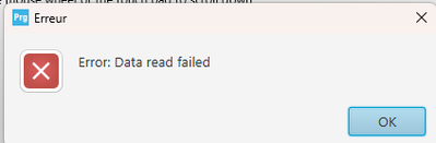

When I connect with STMCubeProgrammer, I have this error (normal , read is protected) :
But when I read Option Bytes, RDP =0xAA!
