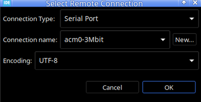

No - just try it :
in IDE , bottom window : console view
click on -> small dropdown arrow , right -> command shell console
you get :
first time : -> New ....then choose the USB-serial (on your system maybe COM9 or...)
and you are there.... :)
(next time : name field should show your already made connections )
IDE (eclipse) is very powerful - just the problem is: how to find or set , what you want (not only for you, same for me...).

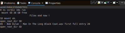

Then looks like this - when connected:
