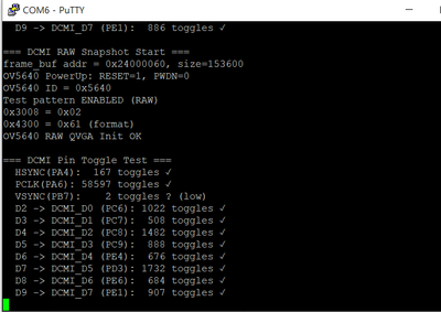

I'm currently facing the same problem — the **DCMI interrupt never fires**.

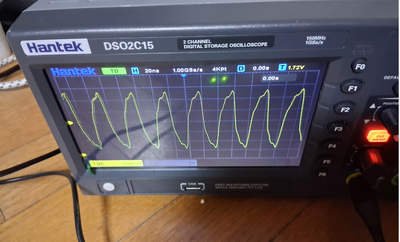

The 24 MHz XCLK output on **PA8 (MCO1)** is confirmed with an oscilloscope, and **I2C communication with the OV5640** works correctly (the device at 0x3C/0x3D acknowledges and initialization completes).
However, neither `HAL_DCMI_FrameEventCallback()` nor other DCMI callbacks are triggered.
All related configurations seem correct:
- DCMI and DMA clocks are enabled
- GPIOs for D0–D7, HSYNC, VSYNC, and PCLK are set to **AF13_DCMI**
- NVIC interrupts are enabled for both DCMI and DMA
Despite this, no frame or line interrupt occurs.
If you’ve found a fix or have any insight into what might be missing (timing, polarity, DMA setup, cache issues, etc.), please share — it would be a big help!
