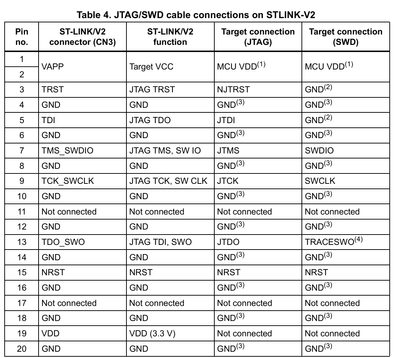

My name is G. Sai Deepak. In our railway project, we are using the STM32G4A1VET6 microcontroller. This is how we have designed and connected the microcontroller in the schematic. I kindly request you to review the schematic and let me know if any changes are required

Hi, Thanks for your response Yes, it's Matching and we are following the Pin out from the below mentioned Link and I have mentioned the pic of the section that we are following
Thanking you
2025-09-11 9:14 PM
Hi, Thanks for your response Yes, it's Matching and we are following the Pin out from the below mentioned Link and I have mentioned the pic of the section that we are following, Please Provide your feedback

As I said before:
I don't use JTAG so would rather not weigh in here. The programmer manual should detail what connections are needed.
You said you are using SWD, but you are definitely showing a JTAG connection. Note how pin 3 is not used for SWD.
2025-09-15 12:02 AM
Hi, Thank's for your reply. We are using JTAG Connection
