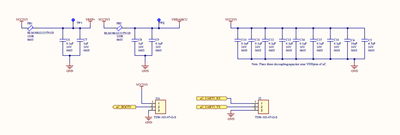

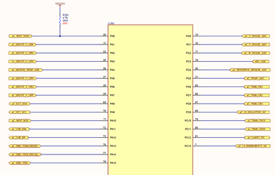

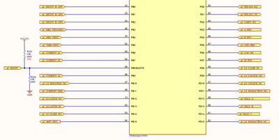

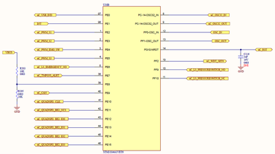

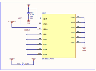

My name is G. Sai Deepak. In our railway project, we are using the STM32G4A1VET6 microcontroller. This is how we have designed and connected the microcontroller in the schematic. I kindly request you to review the schematic and let me know if any changes are required
Thanking You,
G.SAI DEEPAK
2025-08-08 6:31 AM
Looks okay to me at a high level except that I don't see a programming header. Presumably that's somewhere.

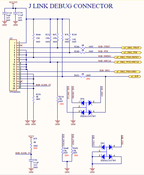

2025-08-12 6:19 AM

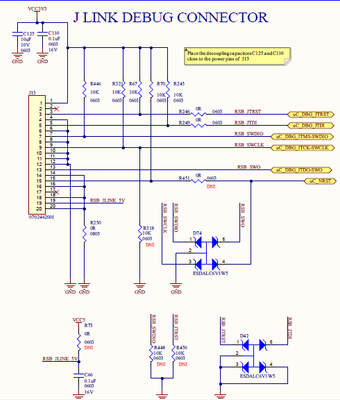

Hi, This is the programming header we have used for our project which is a J-Link Debug Connector, Once check it and review it from your side

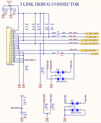

2025-09-01 5:12 AM
Hi, This is our programming header Could you please review it and give your feedback.
Thank you

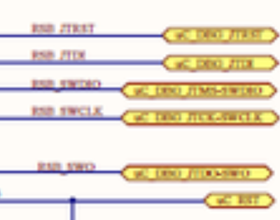

2025-09-01 5:24 AM
Two things:
Here's your image blown up. It is painful to read due to being nearly illegible. A PDF would be better, or a high resolution image.
I don't use JTAG so would rather not weigh in here. The programmer manual should detail what connections are needed.
*ST-LINK/V2 in-circuit debugger/programmer for STM8 and STM32 - User manual
2025-09-01 9:01 PM

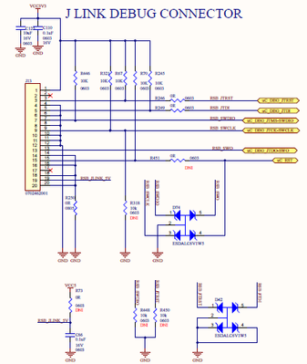

Hi, Thanks for the response. I hope now you get clarity on the Programming header image used in our schematics so, Please Review it and provide feedback
2025-09-01 9:52 PM
We are using SWD for STM32H743BIT6
2025-09-04 3:51 AM
2025-09-04 6:21 AM
Looks roughly okay, though a lot of those pins are not needed for SWD. Does it match the pinout in the programmer user manual?
2025-09-05 3:52 AM
Hi, Thanks for your response Yes, it's Matching and we are following the Pin out from the below mentioned Link and I have mentioned the pic of the section that we are following
