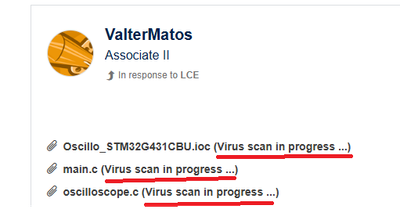

> I've attached the compressed file.
Most people don't like 1) downloading 2) unzipping 3) ... stuff.

As stated previously there is an issue with the attachements these days:
We cannot download any of your attachments, so better to post your code using </> button.
Read How to insert source code
You need to share your linker file + the code.
