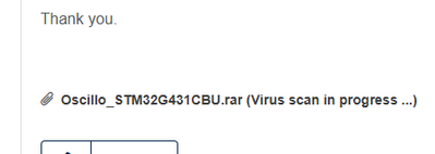

On a loosely related note, the recently displayed message "Virus scan in progress..." for attachments suggests no such scan had been in place before ...
2025-12-10 6:54 AM
Unfortunately, your project is stuck in the virus scan:
See: Attachments stuck on "virus scan in progress..."
