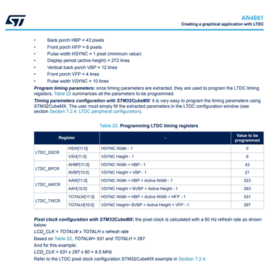

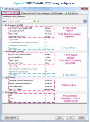

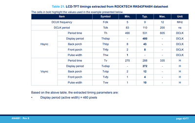

2025-07-14 1:22 AM - edited 2025-07-14 1:43 AM
Hello @Franksterb92;
Could you please check the LTDC timing configuration?
I recommend rereferring to AN4861 "Introduction to LCD-TFT display controller (LTDC) on STM32 MCUs" application. This application note provides an example of the timing configuration for ROCKTECH RK043FN48H.
I hope this help you.
Thank you.
Kaouthar
