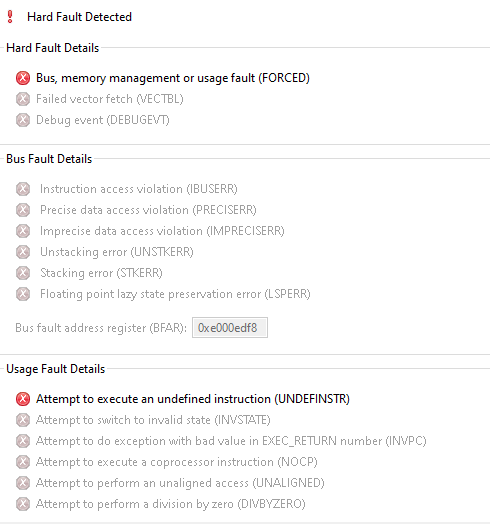

Hello, i just implemented the EEPROM Emulation example. It worked a few days perfectly.
The i added a ADC via CubeMX. Now i always enter the hard fault handler after EE_Init() was called.
Any idea? Thanks a lot

I am not able to handle this error according this informations.

Undfined instruction execution may be trickier, though, maybe result of stack overflow, incorrectly used function pointer, etc. Usual debugging techniques apply, e.g. blocking out parts of code to find out where's the culprit, observing registers and stack to find the execution path before the fault, etc.

Thank you. Yes i want to learn it for shure. But without asking i am not able to handle this error right now.
I use the EEPROM_Emulation example. When i remove the EE_Init everything works fine.
This kind of errors are out of my range right now.
