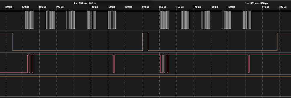

2023-12-01 2:57 AM
Logic analyzer Image
White -> sck
Second orange -> CS
Red is -> MOSI
Last is -> MISO

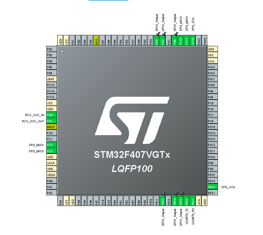

This is spi initialization and below is my used pins
