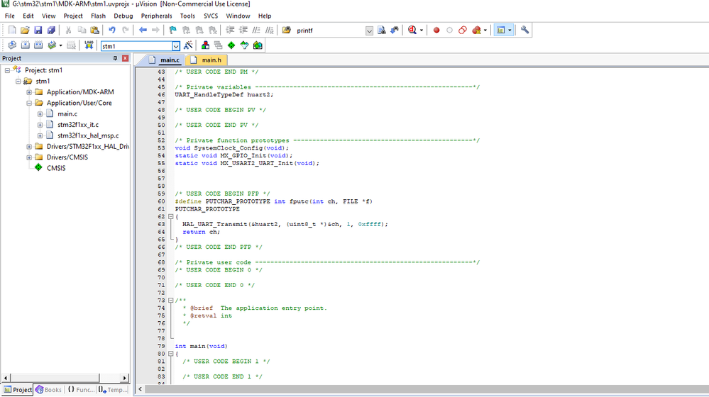

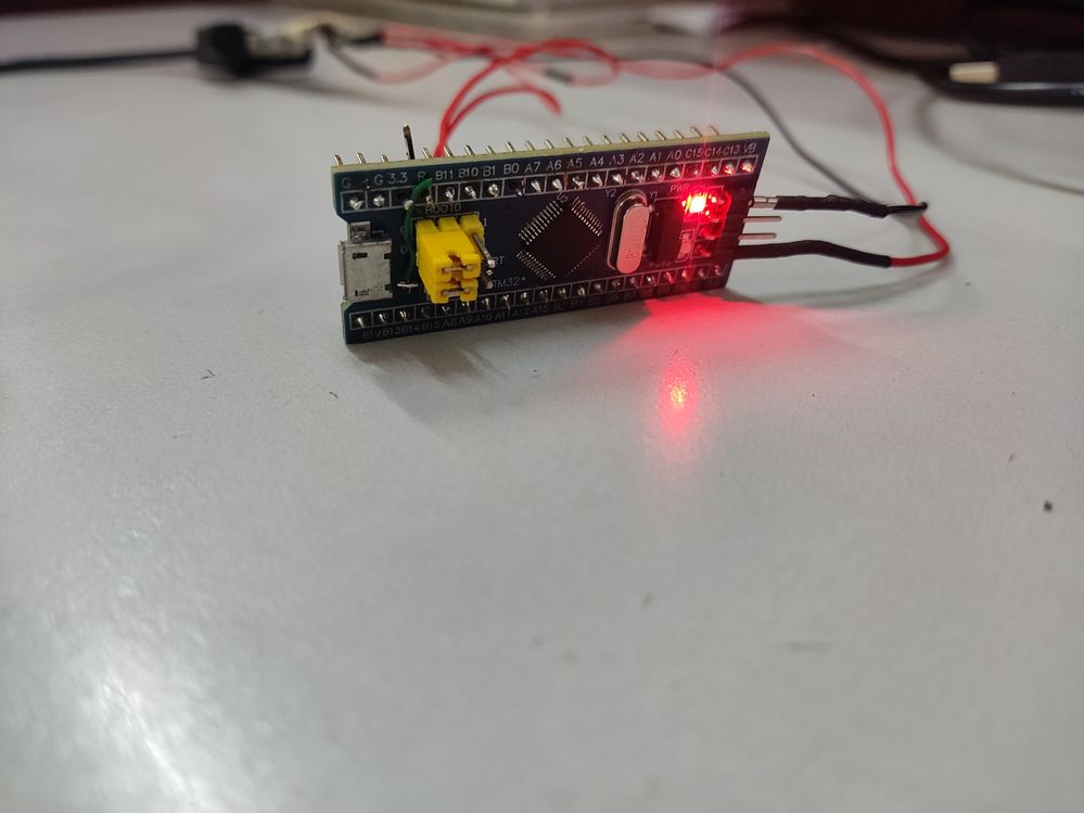

hi im using stm32f103c6t6 arm controller printf is not working i followed steps which provided a peace of code attached.

2023-03-31 2:26 AM
yes its working fine but i need to print it using printf if i put printf its not working.
for that im enabling led in EV board if i put printf the loop is not running.

2023-03-31 5:51 AM
https://community.st.com/s/article/how-to-redirect-the-printf-function-to-a-uart-for-debug-messages
This example i referred which is from stm community. not worked

2023-03-31 9:13 PM
hey @Community member its not working same problem if i put printf in while loop the loop not executing.i pasted my code down please resolve my problem.

2023-04-02 9:04 PM
the problem is same for this code too. i loaded your code see suddenly the loop is hanging and led not working i'm not getting why its not working. In other stm family that small code is working but here not working.
