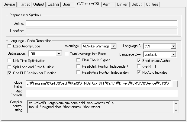

The C/C++ options for Target are configured as shown here:

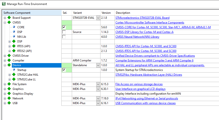

I started a new project, selected the chip, and configured the run-time environment as below:
