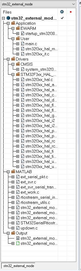

I testing STM32-MAT/TARGET. I started with development of new project in MATLAB SIMULINK. Actually I have trouble with genarating of the project for SW4STM. Generated project from my simulink model has structure left on attached picture, bud the structure should by like on the right side of the picture (Application, User, Drivers..).
When I started with my project the structure was similar like the right one and everything worked fine. Bud I had some troubles with generated code, a made modified some parameter in Model configuration parameters. And then generated project structure was changed. Why? Which parameteres affected this? I tryed to creat new project but the generated project's structure is like the left one.
I made some algorithms test with mormal and external modes.
The problem with project structure on the left is that I have to manually add source files and headr files for MATLAB code to Path and Symbols to compile the project. In external mode about 10files has to be manually added every regeneration of the project, it is very time consumming.

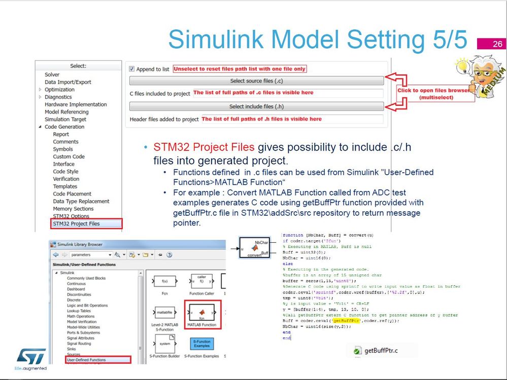

Before you build the project, have you try do like process from in instruction?
This is my EWARM workspace from external mode.
Could you please give me more information?
If you provide a little test case if possible or at least an simulink file or project file.

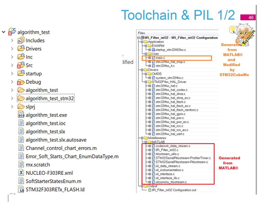

I am assessing the STM32 MAT/TARGET toolchain for an STM32F7 board as well. I have also selected the Atollic Truestudio IDE, since it is free and is owned by ST (so I expect full support there).
However, I am facing the same problem as you. The generated project structure is not as expected and the Truestudio compiler cannot find the files (mostly header files) in the MATLAB-specific folder, algorithm_test in your example.

As far the toolchain is concerned there are known issues with eclipse-based tools, especially for include paths and build resources that can be defined as excluded.
It is an issue with the project generator that is used.
In the current situation, in the project generated for these types of IDEs, check the include parameters for the paths and verify that the build resource is also enabled.
