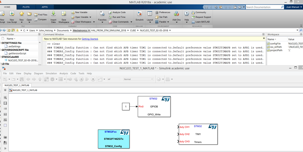

I have the next error in the command window of Matlab 2018a''TIMERS_Config function : Can not find which APB timer TIM1 is connected to.Default preference value STM32TIMAPB set to APB1 is used.''

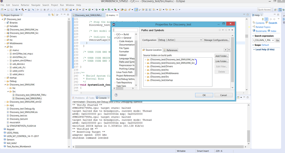

TIMER4 is assigned to APB1 clock. I also configured the APB1/2 clock frequencies in the STMCUBE project based on the datasheet of the microcontroller. Finally,I imported the c files generated and compiled by Matlab into the IDE S
ystem Workbench for STM32 to program the Discovery board. (See Files attached, To compile the program generated by Matlab (INC, SRC) you have to manually add the folder with the INC and SRC files of matlab into the Workbench project go to the tab: /project/properties/C/C++ General/Paths and Symbols/Source Location/Link Folder option).
Then, in the second project I was trying to test the Nulceo board with the STM32F746ZGTx microcontroller, I also create a simple STMCUBE project using a GPIO as input and other as output, but this time the TIM1 as PWM generator. However, in this type of microcontroller TIM1 is assigned to APB2 according to the
. I also set the properclock configuration for APB1/2 in the STMCUBE project. Then I proceed to create the Simulink model, the GPIO block works fine without any problem, but when i tried to implement the ''STM Timer block'' i got the next error in the command window of Matlab.
''TIMERS_Config function : Can not find which APB timer TIM1 is connected to. Default preference value STM32TIMAPB set to APB1 is used.''
To try to solve the issue, I have tried different frequencies configurations for APB1/2, I also check the ioc files using Notepad++ to see what is inside of the script and APB2 is assigned, but i could not find any solution still the same error in the command window.
So, my question is How the ''TIMER block'' of Simulink automatically recognize the type of clock assigned (APB1/APB2) according to the CUBE configuration ioc file?
Is there something missing in my ioc CUBE project that i need to set to assigned TIM1 to APB2 for the Cortex M7?
Is there a kind of button or check to select or enable APB2 for TIM1?
Find Attached the STMCUBE project for the Nucleo-
STM32F746ZGT
board and the Simulink project.best

Hello Juan Manuel,
the APBx bus is assigned by STM32 design and cannot be "chosen". Each timer is connected to the specific bus interface and this interface controls the clock, reset, low power activity of the peripheral etc. Further, APB bus distributes the clock to the TIM and because it's operating speed may be limited, the timer core clock has a multiplier by 2, if AHB/APB >= 2.
The first answer: the CubeMx has the information and generates the init code for given TIM with proper clock enable sequence on proper APB bridge registers (RCC peripheral).
If you need to tell Matlab (because it needs to understand what clock the TIM is fed with), you can check block diagram in the datasheet, where assignment to APB's is depicted, or, Reference Manual, where in Table 1. STM32F75xxx and STM32F74xxx register boundary addresses this information is mentioned, too.
