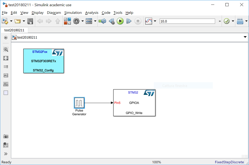

2) start simulink and create a new project. i configure it as ST say in readme.pdf document provided in the installation directory of STM32-mat targhet.
3) click ''build model'' and wait for everything to end. cubemx say that ''the code as successfully generated''

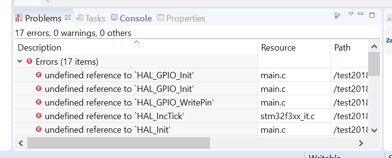

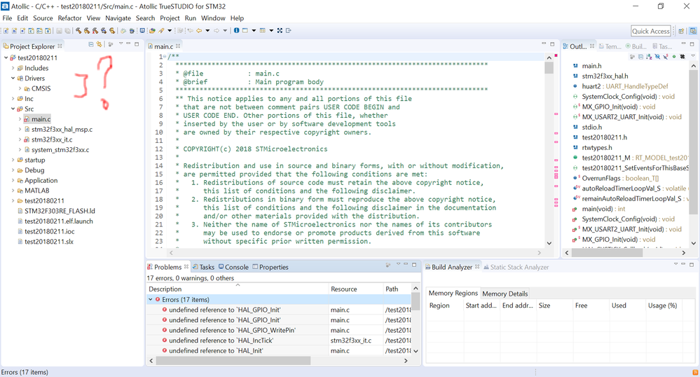

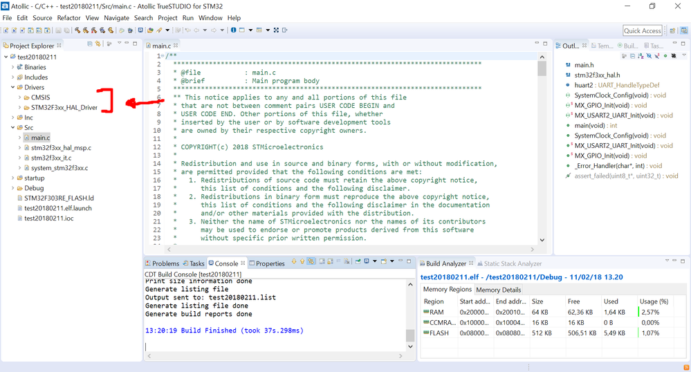

4) i open open code with truestudio, i try to compile it and i get 17 erros. all error are consequence of missing hal driver.

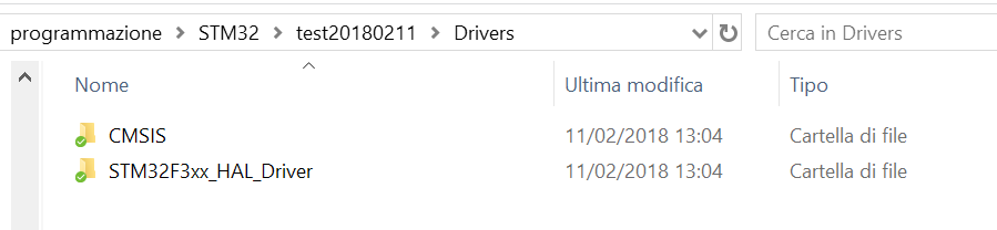

it seems that in the driver folder there isn't hal driver library, but if i navigate to driver folder manually all files are in their place .
if i use cubeMX without simulink (using the same .ioc files used with simulink) for code and project generation all works fine and truestudio include hal driver during building.

i try to build a simple ''hello world'' project, like flash a led.
when i click ''Build model'' matlab make it's work and doesn't show any error.

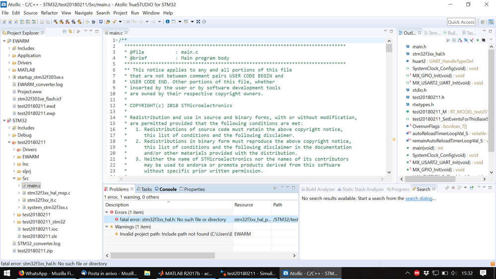

When i open project with truestudio and i try to build it i receive that errors:
i've partially solved the problem under the advice gived by
in another thread of this forum:https://community.st.com/0D50X00009XkWopSAF

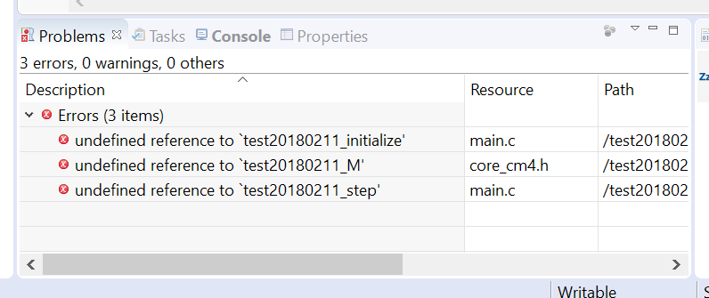

after the ''.project'' modification all error related to hal libraries are solved, but i receive three other errors:

i tried to change toolchain from Truestudio to ewarm, but i haven't ewarm installed on my pc. so i tried to import the new project in truestudio, but the result is something like that:
Thank you

I have contacted ST. It's a project generation problem regarding STM32CubeMX.
And ST is working on that.
