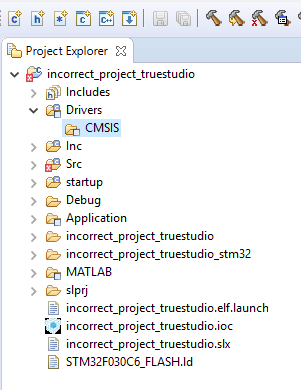

I begin with the first problem that I encountered: the projects generated by STM32-MAT / TARGET ''cling'' not all of the directories �include� and �source�.
The problem manifests itself for both the IDE, SW4STM32 and TrueSTUDIO, but a little differently.
With SW4STM32 projects, everything is relatively simple - the code generator does not add the <project_name>/Src path to the project files. It is necessary to prescribe manually.
With the project TrueSTUDIO is going through more strange things: the contents of the Drivers/STM32F3xx_HAL_Driver directory are not completely visible through the Project Explorer:
The files in this directory are ignored by the compiler.
And, it looks like the problem is in the ''.project'' file.

If you delete them, the Drivers/STM32F3xx_HAL_Driver directory becomes visible through the Project Explorer and is no longer ignored by the compiler. But, again, you have to manually assign the paths <project_name>/Inc and <project_name>/Src.
