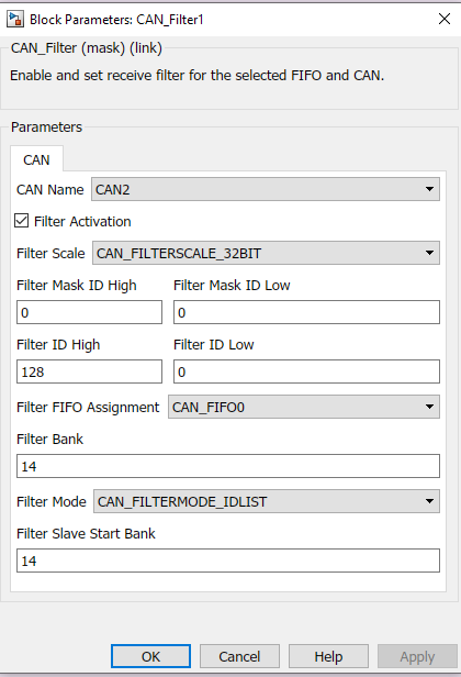

This is the code generated for one of the CAN_Filters, and below you can see the corresponding settings of the block. As you can see, the parameters are written into the code directly instead of as a function call argument, which is why the code cannot be reused in the C-code.
